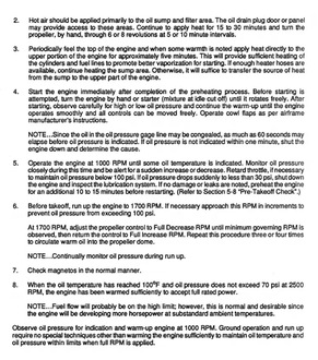

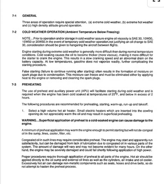

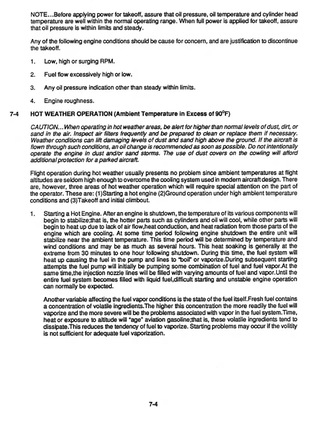

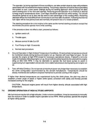

Jhogan0101 12-21-25 07:29 AM
4 Attachment(s)
https://www.scribd.com/document/5165...t-Operator-360
Attachment 3136
Attachment 3137
Attachment 3138
Attachment 3139
