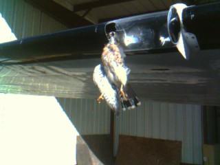

Dad killed a red-tailed hawk with his starboard landing light lens cover. Never even knew it until he started to put it in the hangar. The problem is neither of us have a parts manual handy(mine's 70 miles away in Nashville and his is in Naples). Does anyone know the part number for the replacement lens?

I think you want a 1422550-12 if your aircraft S/N is up to 337-0379 or 1422550-20, which is the more current number. But it's for the entire lamp assembly, and there's no P/N for just the lens. See figure below. Shouldn't be hard to find from yards that disassemble aircraft. Try Don Nieser first at 405-503-4686 or 405-722-4079.

Dad got the part from Great Lakes Aero Plastics. $35 plus shipping and handling. He received the part Thursday morning, got all the screws out of the frame O.K. and the new lens fit perfectly. Done.
He killed a hawk with his Skymaster and it cost him less than $50 for repairs. It probably would have cost more if I had killed one with my car.
