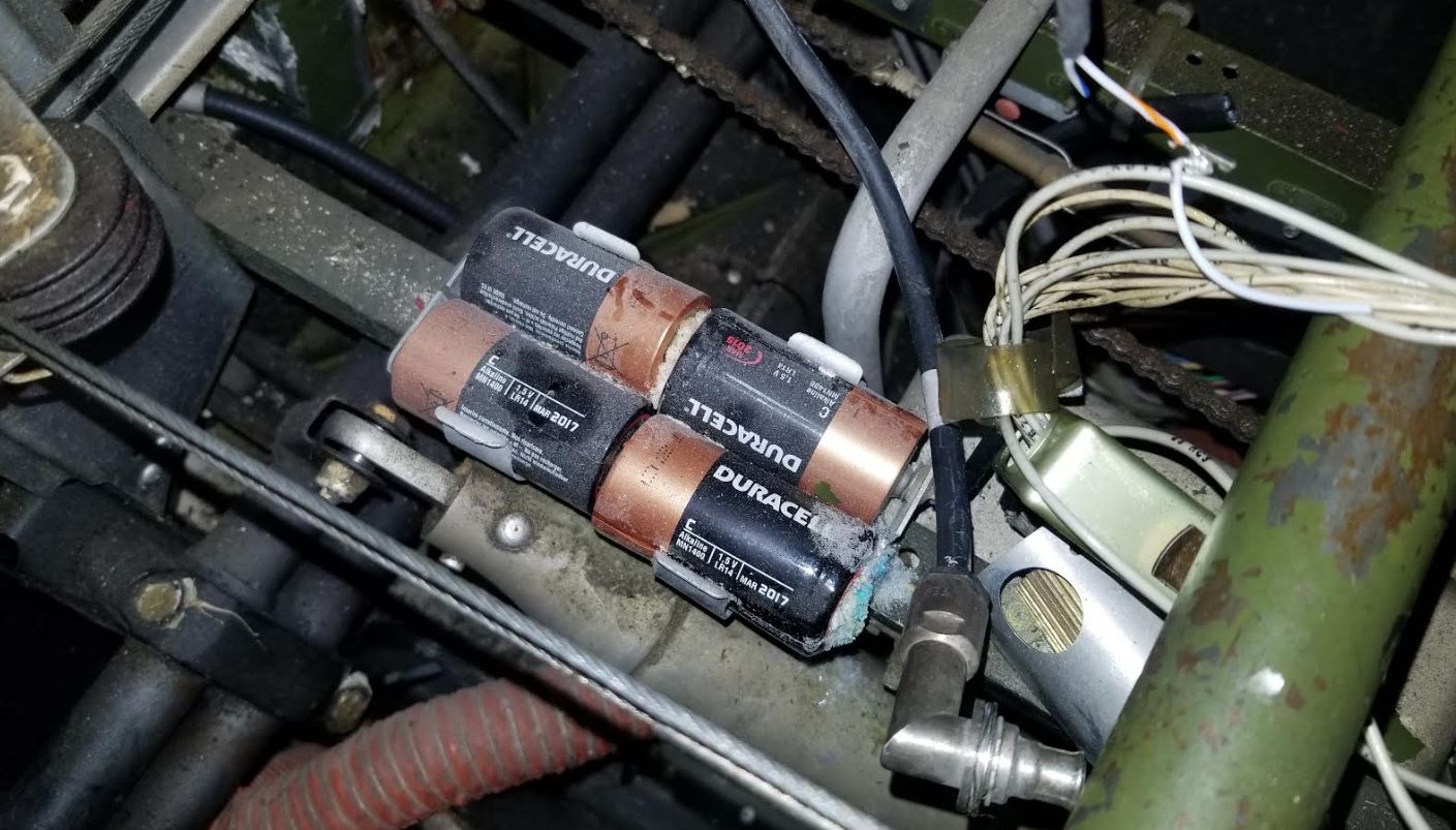

So im getting an avionics upgrade and my tech mentioned I have 4C Batteries that are corroded...Here is picture
Attachment 2777
What is it for and what does it actually do?

patrolpilot 09-13-22 09:16 PM
Yep, that's the restart pack. The pilot is supposed to test the system every 25 hours. I don't suspect that has happened.

That really needs cleaned up, and make sure the ground side is still connected. The batteries are used for alternator restart in the event they get knocked offline. The restart procedure is in your POH and spelled out in the maintenance manual.

Your restart system is likely fine, but that battery tray needs to come out and be scrubbed with water and baking soda until all the corrosion is gone.
Battery acid is nasty stuff and can be very destructive, so add "C" batteries to the list of things to check at annual, and test the system every 25 hours as mentioned.

Thanks for the info, I was told the tray was beyond cleaning...its going to get replaced.
