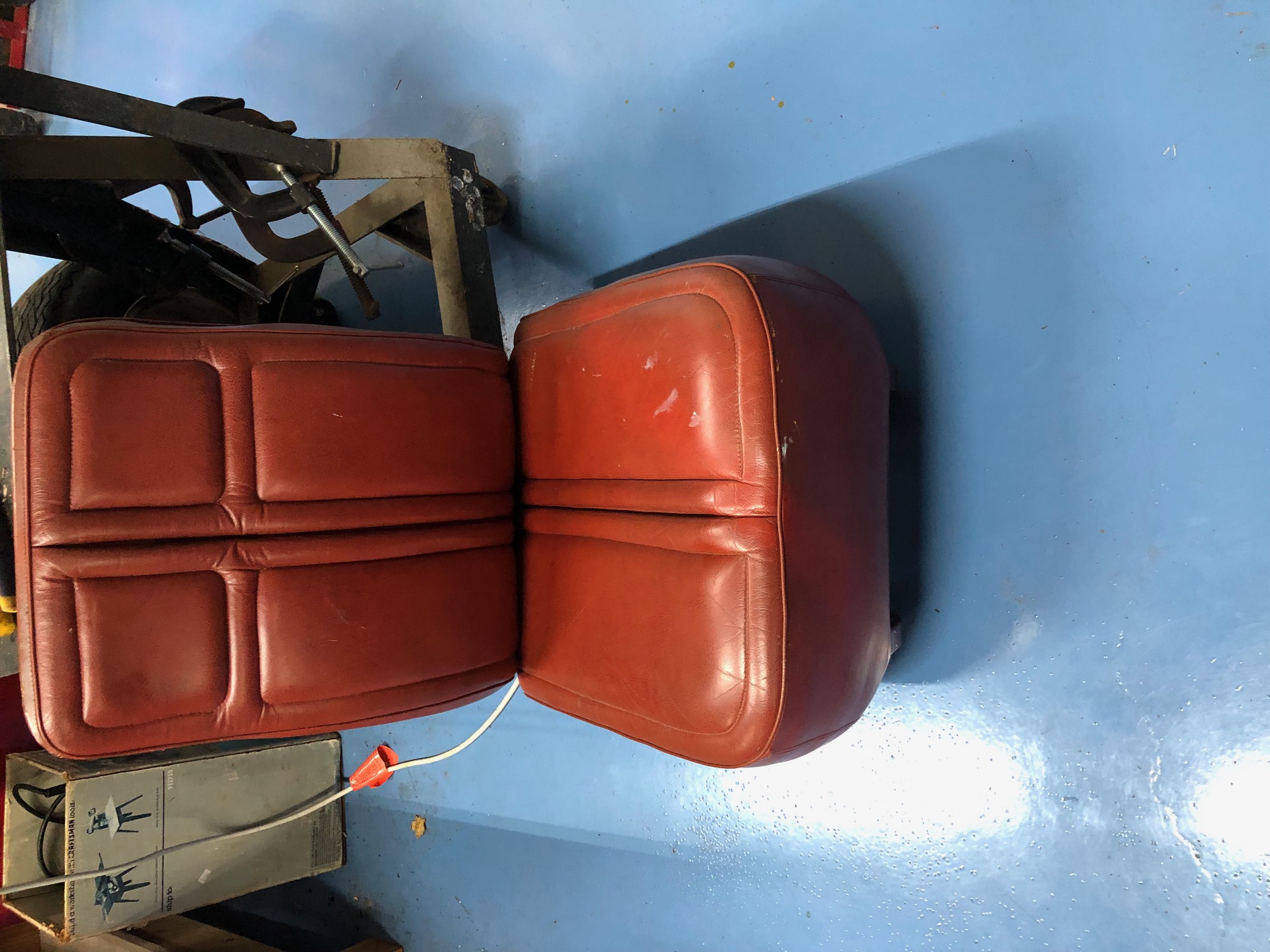

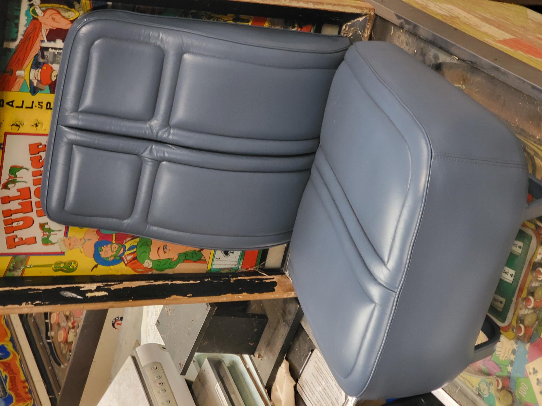

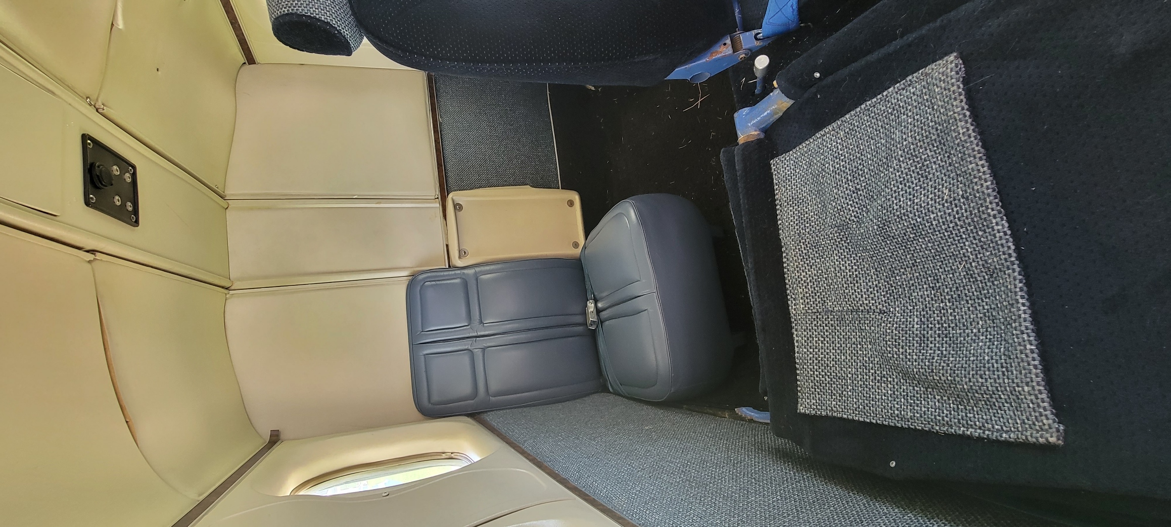

Thanks to a member here, I now have my 5th seat installed!

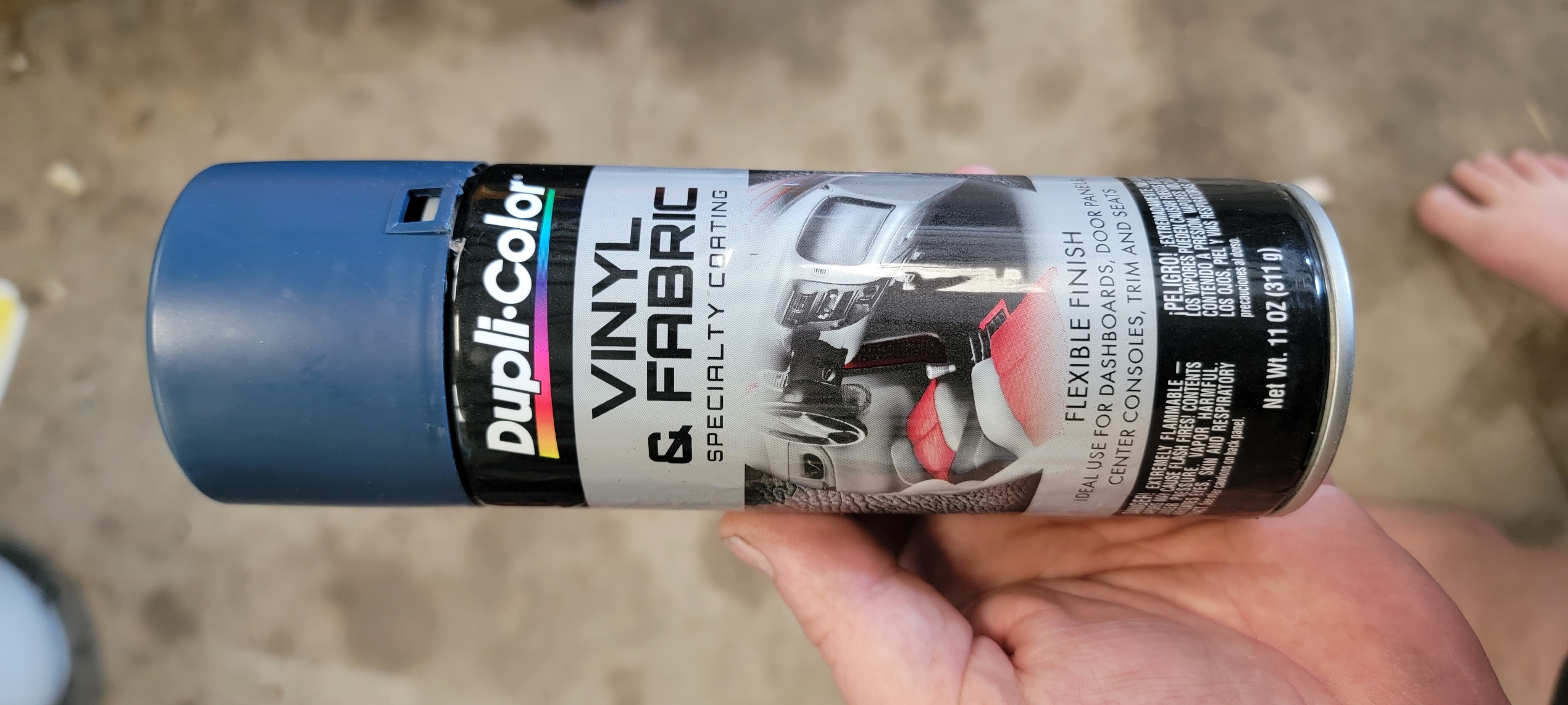

It was red when it arrived, but I used vinyl paint to change the color to match my airplane. Took two cans. CLEAN IT WELL first with 70% rubbing alcohol (or similar).
The secret is many light dustings, no heavy coats.
Looks like it came from the factory - I'm very satisfied.
