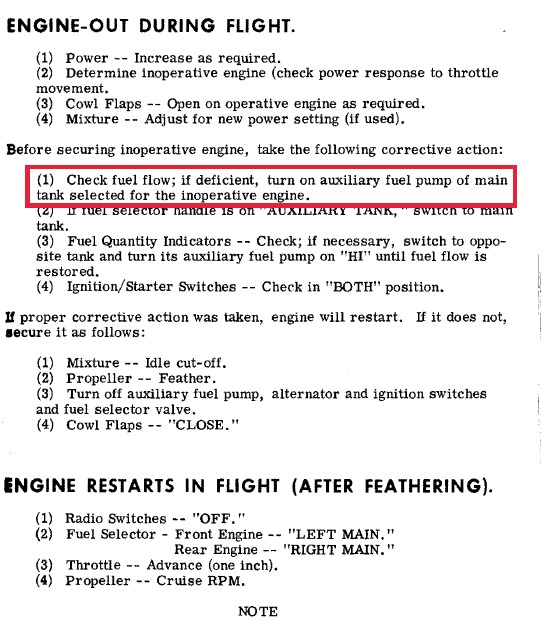

TomM 10-04-23 10:15 AM
1 Attachment(s)
The use of the electric fuel pump in flight is part of the emergency procedures. It is not normally used other than to start as you noted.Attachment 2980
But is does provide enough fuel to operate the engine
sunnysky 10-04-23 01:50 PM
fuel pressure
yes. Tom M . your Skymaster is different to the G model.
we dont have auxiliary tanks. just a very simple two tank system
with a facility to select the feed to the engines from either tank.
but as we seem to both agree, the auxiliary pumps are only for engine
start or restart in the air.
not to try sort out low fuel pressures in normal operations.
the original contributor was suggesting using the electric pump in an non approved way
