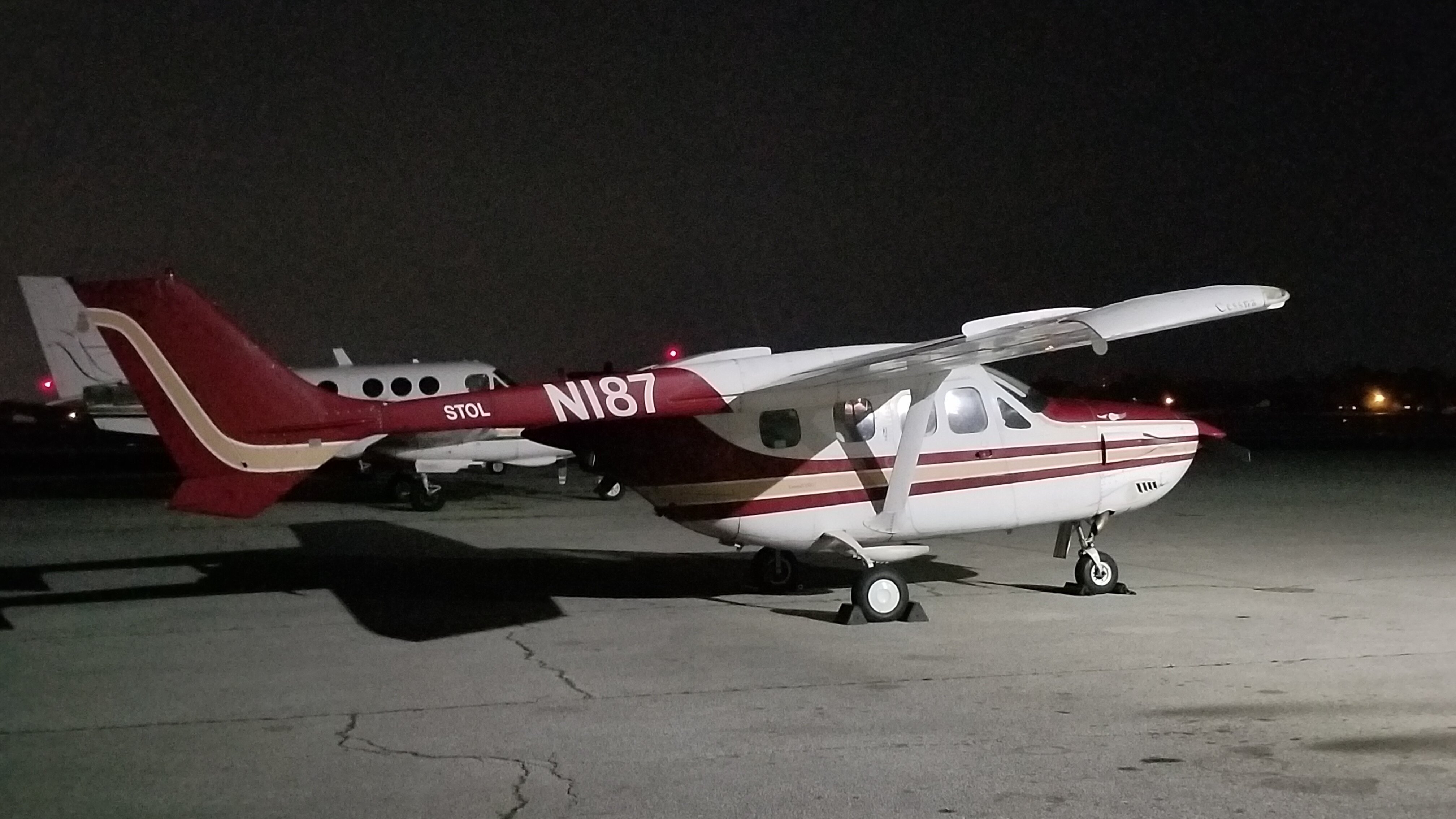

Here she is after my flight home.

Nice!
Looks like it has intercoolers. You're gonna want to check all that intake piping for leaks on the front engine.
