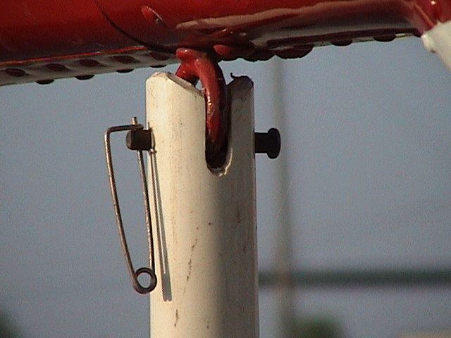

Hey Fred,
Do you have a closeup picture of how those things are attached to the boom? I notice they hang loose until the snow gets too heavy (kindof like their owner, I guess ;-). Are they PVC pipe, or...? I know I have read a discussion of this somewhere, but I have never seen good pictures.

Talking Boom Leg
Will this do. Sch 40 1" PVC is what it is made of. If you need more help let me know.

Thanks Fred. It looks like the tail will rest on the structure immediately around the tiedown, rather than the tiedown ring itself, because the pipe will touch first. Am I correct, or confused? I take it this area is strong enough to take the load? (Hope the question makes sense.) Very good picture, thanks!

Talking Legs
No Kevin they do actualley set on the rings, just make sure you don't make the slot in the leg to deep, if you do , just trim a little more off the top. If you think I need to take another picture I will.
I could make a few sets of legs to bring to the meeting in OKC if you think anyone would be interested.
