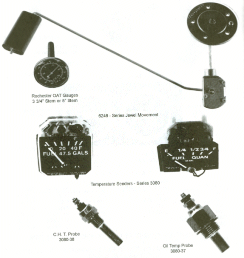

I see that I had never answered this:
Rochester P/N: 3080-38
Type that P/N in the search box on the Aircraft Spruce website, cost is $64.25
