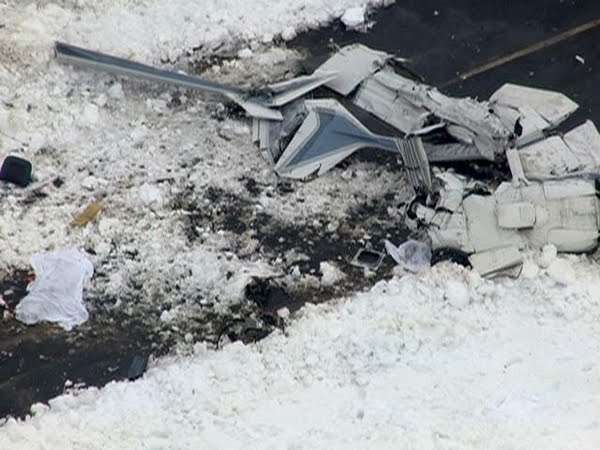

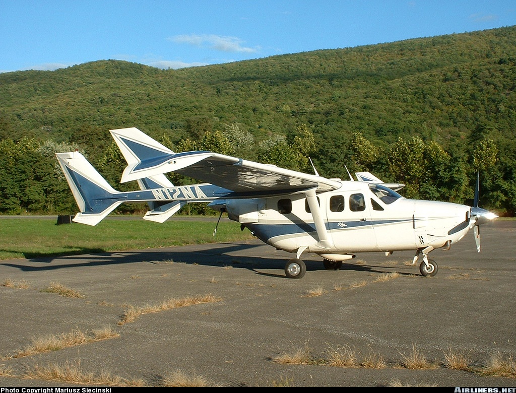

This aircraft has Winglets, as depicted in the video on the link above. I have to speculate that this may be N12NA, a Riley Super Skyrocket. Again, this is only a guess based on the winglets and the paint scheme. This aircraft, N12NA, has the extended wing tip tanks also as shown in the picture below. Tragic accident, the media makes it sound like something came off the aircraft while it was landing. This is awful.
http://www.nj.com/news/index.ssf/201...lane_cras.html
By looking at this photo I can see the boom with N12 on it.

If you watch the video you'll see the right wing tip broken off over the runway. I noticed it had the wing tip mods too. Not sure if the two things are related, but here we are all talking about the wing root inspections.....perhaps Cessna overlooked something. Notice how the wing/fuselage mounts are still connected even after the accident.

Terrible . Hard to surmise what happened at this point, because of all the different info from witnesses. Some say the plane was going very fast which doesn't sound right for a take off. But the gear was allegedly up, so it would appear that it could have rotated and cycled up. More likely a landing or low approach, or missed. For the wing tip to be in the position it is in, it seems like it might have hit before the accident, i.e. scrapped the runway, broke off, then flipped? Marks on the runway may tell the story. Regadless, what a horrible thing.

It appears that it probably was N12NA. The Fox NY web site's TV reporter broadcast says that: all five victims have been recovered, that the FAA said it was a 1973 T337 registered to Jack Air LLC, Wilmington, Delaware (which matches N12NA's FAA Registration info), and that an eyewitness saw the aircraft with the gear retracted approach the runway, hit the runway with the gear retracted, and pull up after hitting the runway.

I keep wondering if they were just doing a low approach fly-by, like many of us do. If that was the intent, what went wrong? The right wing tip was not damaged from hitting the runway but appears to have just broke off at the extended fuel cell attach point. If the fuel cell broke off while performing a fly-by at high speed this could roll the aircraft clockwise very quickly. One would expect that it may look similar to the reports that witness's described. If this is the case why did the fuel cell separate? High speed? Structural? We may never know.

I don't know which optional tanks it had. Given the winglets are Aviation Enterprises maybe the fuel cells are also. I know that some of the optional tip tanks do have a jetison system so that if you have to land before exhausting the fuel the fuel can be dumped so that the gross weight is legal for landing. The increased gross weight is for T/O and flight only and not landing.
Here is the info on the Flint extended tip tanks. It increases the Gross Wgt to 4,630 except where the GW is already 4,700 from Cessna. No dump system on the Flint Kit.
