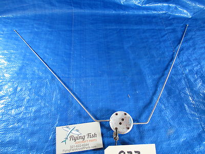

Got a question. Does any body or every body have the "V" shaped VOR antenna mounted on your C337? Currently I have a Dorne & Margolin DMN 42 antenna mounted on the vertical stabilizer and it old and heavy, I'd like to install the lighter "V" style, common on single engine Cessna. What do you think?

I am talking about the thin stainless steel whiskers with a round plastic attached in the middle. Did you see the picture I sent?

I did see the photo. I suppose I should have said the photo appears very similar to what is on my plane. I cannot say for certain because I would have to remove the fin cap on top of the vertical tail to see if the mounting is the same. The "V" whiskers are on my plane so I ASSUME???? the mounting is the same but not certain.

The "V" style whisker antennas at the top of the vertical stabilizer on my Skymaster (and I suspect all others) are mounted differently than those shown in your photos. Each antenna (whisker) is mounted in a nylon insulating block, which in turn mounts to the vstab structure. This is all hidden beneath the plastic fairing.

Thanks for the information. I'll have to see if I can "fit" the one I have to my bird?
