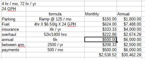

Hi all. I'm prospecting for a Skymaster and have put together a spreadsheet of operating (really, owning) costs (snippet in attachment). Was wondering if anyone would care to comment on the reality of these numbers for 2015/2016. The "payments" are based on a roughly 90k aircraft (details were determined by loan calc, so assume the payment is correct). I also raised the tie-down to $150, but forgot to note that at the top left (where it still says $125). I've also assumed the 185-190Kt speeds that I've seen others recall as taking 24ish gph for the turbo. Perhaps then my annual and O/H is too conservative a budget?

you really should plan for a hangar. You don't want to leave $90k in the rain....do you?

I was afraid someone would say that. And no, I don't. But this would put that budget over $3k a month and that's a big nut. But okay, putting that aside for a moment, do the rest of the numbers look about right?

Your estimate might be OK some years. Likely not the first several years though. Frankly in my opinion it is almost impossible to predict what it will cost annually to own a 50 year old complex airplane. Obviously the fixed costs are easy but maintenance is such a huge wild card. Your $8500 annual maintenance budget (unless you're an AP/IA doing the work yourself) is likely too low most years in my experience operating a 1973 337G since 2002. My annual maintenance range has been $8000 (best year) to $21,000 (first and worst year). I consider anything under $10,000 in annual maintenance an excellent year. I don't start feeling sad until the maintenance expenses start to exceed $15,000 but I still pay them with ease. I can't stress enough the importance of being able to routinely pay maintenance expenses much higher than planned. Parking the airplane in the Wx will increase your maintenance costs also.
SkyMasters are awesome airplanes. They really are, however you gotta have the money and be OK with spending it or they, as any airplane will eat you alive.

If you need to make "payments" for the airplane then you can't afford it. Sorry to be curt, but it's the truth. An alternative is don't buy the 90K airplane. There are several cheaper ones out there, perhaps older, perhaps with high time engines, but are still airworth. The fixed costs will be the same, such as fuel, hanger, insurance, etc. But the buy-in is cheaper, and you might not feel bad tying-down outside. However, maintenance will always be issue. Just a thought.

Anyway, with exception of your maintenance budget, the rest looks reasonable. I cannot comment on the maintenance budget, as I have no experience with this on the Skymaster yet. However, a rule of thumb I have used owning and maintaining my airplanes for the last 15 years has been: budget 10% of the hull value per year for maintenance - not including hourly expenses (engine or prop reserves). That generally will cover my general expenses for the inspection and fixing of issues from sitting and general wear and tear. Please note, this is me doing my own maintenance (A&P), and some years it is lower, some it is higher.
My point is, these smart guys here on this site are pretty accurate in the numbers they are giving you. If $500 a month More in your budget makes you cringe - then you need to think hard about the purchase. I speak from experience that you can go a few years and be under budget, but eventually something comes along and will surprise you.

My opinion on financing (which I stress is just my opinion) is simply in today's used airplane market, financing an old airplane simply guarantees you are going to pay more for it. In the old days, financing actually made sense because for a lot of years, airplanes actually appreciated in value. You could finance a plane, fly it awhile, sell it for equal or more likely more than you bought it for all the while gaining equity.
Now days, old airplanes are not worth much to start with and are only going down. The older they get, the more people are going to drop out of the market. I paid $90,000 cash for my 337G in 2002 with 400 hour Reman engines and 1800TT. The airplane is a little over 1500 on the engines now and 2900TT and Vrefed the other day at $20,000 retail which means maybe I'd get $15,000 for it and it's a nice well cared for airplane. At least that's Vref's opinion. In other words, the best approach in my opinion is to go into it knowing the buy in is gone forever. Plan on never seeing that money again. If that statement is true, the goal on the buy in is to keep that number as small as possible because the maintenance is where the real money goes.
About the only way financing makes sense, is if you are truly a wise active investor and keeping your cash allows you to put it to work and have it earn more than the cost of financing. Otherwise you are simply increasing the cost of the purchase price. And I agree with a previous post in that if you "need" to finance to buy the airplane, you can't afford it!
