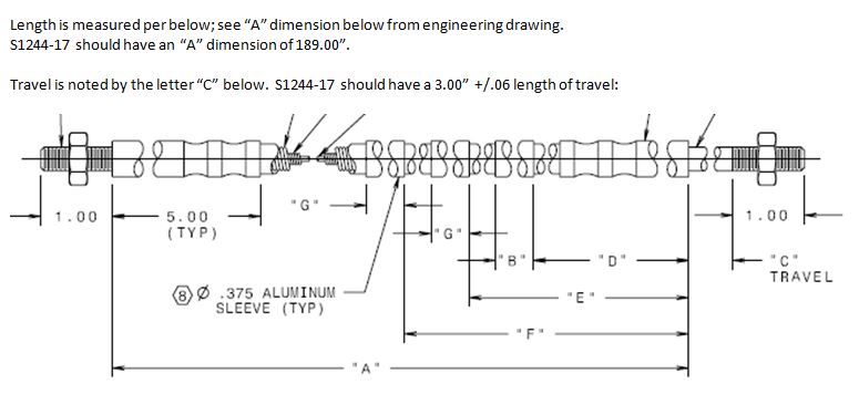

Where did you source your part? That part is used on serial #0001 though #0978. Are you sure the part that went south on you was the right one?
Yes, source was Air Power but box says it came direct from Textron. I've talked with Textron direct and it does appear to be manufactured incorrectly. See attached engineering info on what the cable should be. the new one isn't the same and overall shorter by 1/2" and throw is about an 1 1/2" short too!
Also, what is SK337-8 modification in regards to the Aft Cowl Flap?
