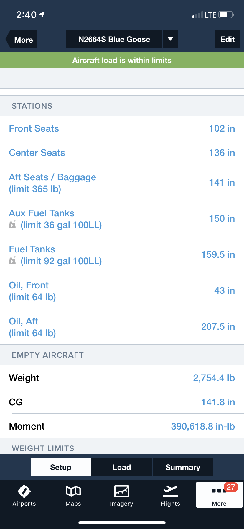

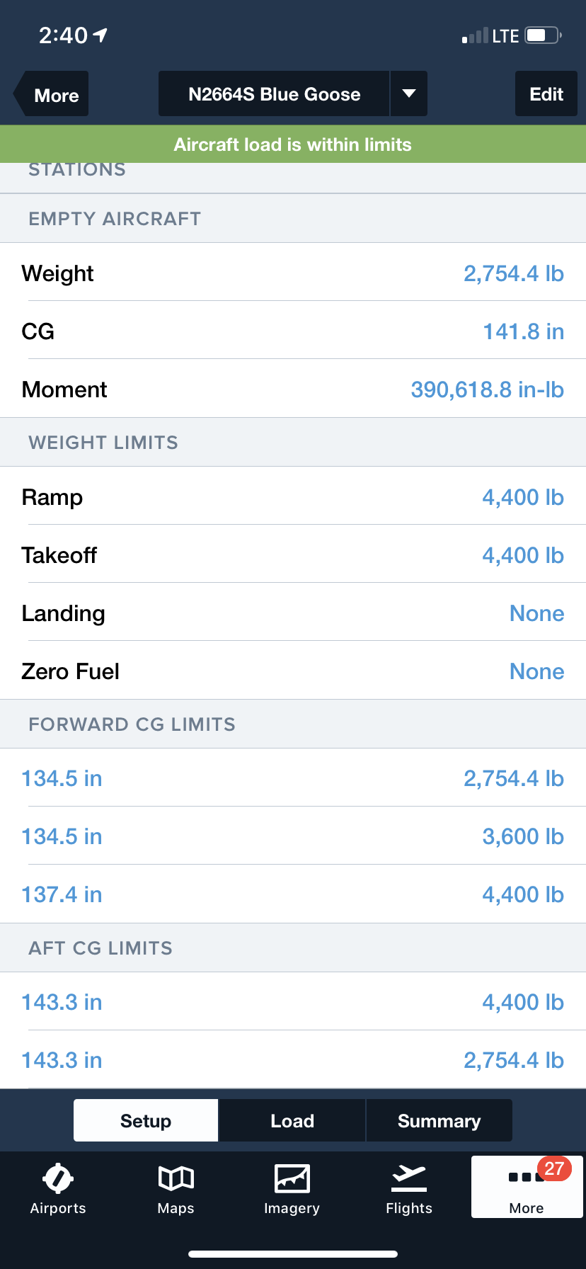

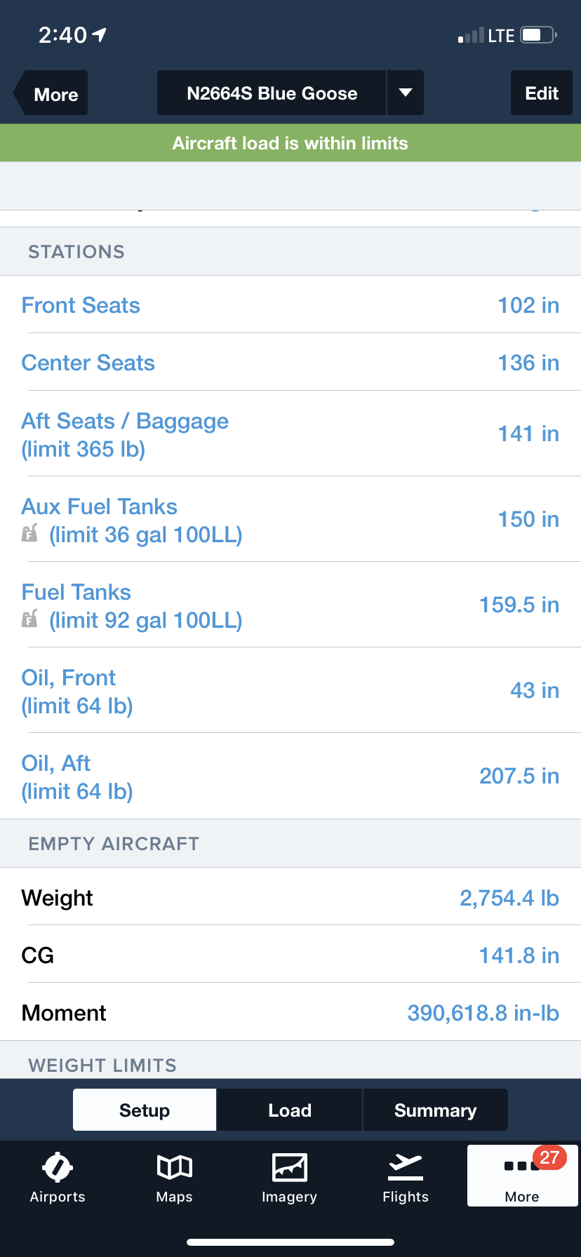

Could you post on here a snap shot of your w&b
Unread 03-17-19, 03:43 PM
Join Date: Oct 2016
Location: I64
Posts: 85
Here’s my entries in ForeFlight for my ‘68 n/a
