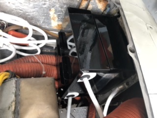

I have the Bogart box. Installed it back in March and got the field approval via my IA. We love it!! He used our old fiberglass box as a template. It was still good we just wanted to upgrade the box and all the battery cables. I've got pics I can try to send later if you want.

Battery box pic
I hope this works. Not sure how to add pics

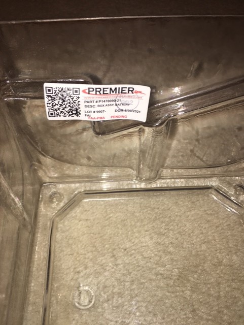

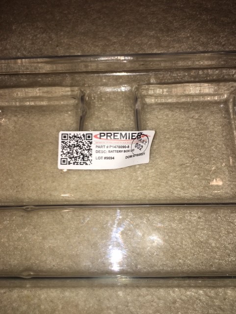

resurrecting this thread.
My 50 yr old battery box finally disintegrated into shards of plastic.
I reviewed with IA about going battery box-less with sealed battery. His concern, battery explosions can still happen with those. Best to have at least some attempt at containment of the battery. We discussed
"owner produced part". But lazy me I gave it one last effort to find an already built replacement. So I went on the hunt again for battery box. I finally found one at a reasonable price, brand new.
Premier Aero Services (web address: premieraerostore.com) phone 1-866-865-1262 makes the battery box. Again, reasonably priced.
I am an E model 337 so this should apply to E and before. (I think battery box changed style with later models-don't quote me on that.)
I have attached pictures. Nice to have a brand new one that fits without the hassle of trying to make something not designed work.
