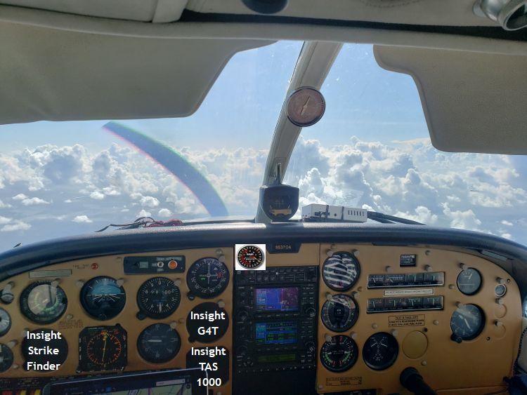

My airplane is going into annual in February, staying on my schedule, I purchased the Insight G4T Skymaster. I bought the TAS 1000 air data computer at the same time and got a considerable discount.
I'm adding a stand-alone 400 HZ inverter to get the Sandel off the autopilot inverter. The new inverter will provide heading sync for both the Sandel and Strike Finder, plus power for the TAS 1000.

G4
I just installed the G4 Twin in mine - you are going to like it. But man, that is a big install with regards to time...worse than installing a new 6 place audio panel/intercom.
I did not go with the TAS 1000 - but since I was installing the dual Garmin G5's, I opted for the GAD13.
Your are going to have a nice panel when done!!!
