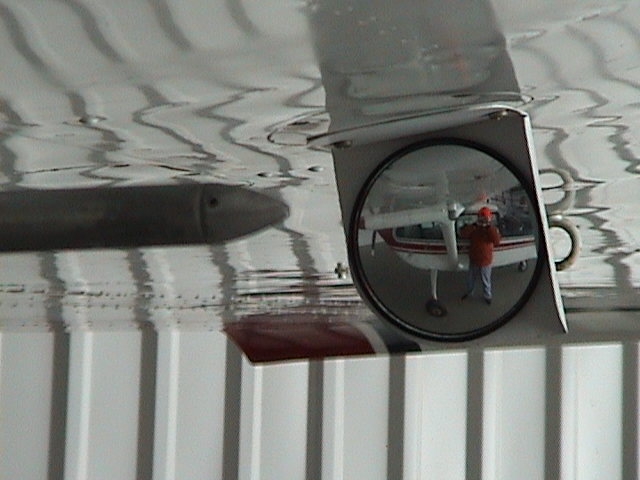

Sten
My mirror is installed with 2 of the screws in one of the inspection plates, I will post a picture within the next few days, with instruction (don't get out much in this ice).

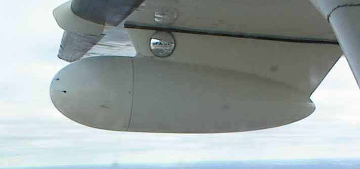

Unread 12-27-02, 08:34 PM
mirror
we have a convex mirror mounted on the strut that supports the radar pod. It is a very simple mounting. I can see the right side gear completely, as it cycles. It is very handy to know that everything is working correctly, and not have to rely only on the lights on the panel.
Also, when in flight, we can actually see the whole right side of the airplane.
Unread 12-27-02, 08:39 PM
Here's a picture of our installation

Unread 12-29-02, 05:57 PM
FRED-E's Avatar
FRED-E FRED-E is offline
Location: Oklahoma City
Posts: 187
Mirror
This is what my mirror looks like. I am going to put one on the other side one of these days.
Fred N358

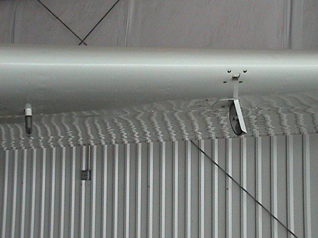

Unread 12-29-02, 05:59 PM
FRED-E's Avatar
Posts: 187
Mirror
This is another of the same Mirror. I can send the dimensions of the holder if you need them.
Fred N358
