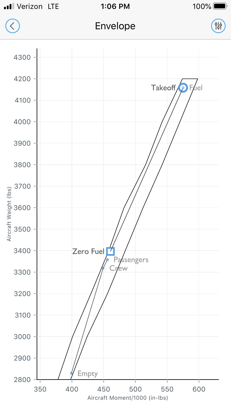

My empty CG for a 337A is 141.1 at 2,820 lbs. The attached graphic is with a 190 pound pilot and 300 pound co-pilot and no issues with full fuel (128 gallons) all the way down to zero fuel. But if you look at the attached, my empty CG is just about at the aft limit.
