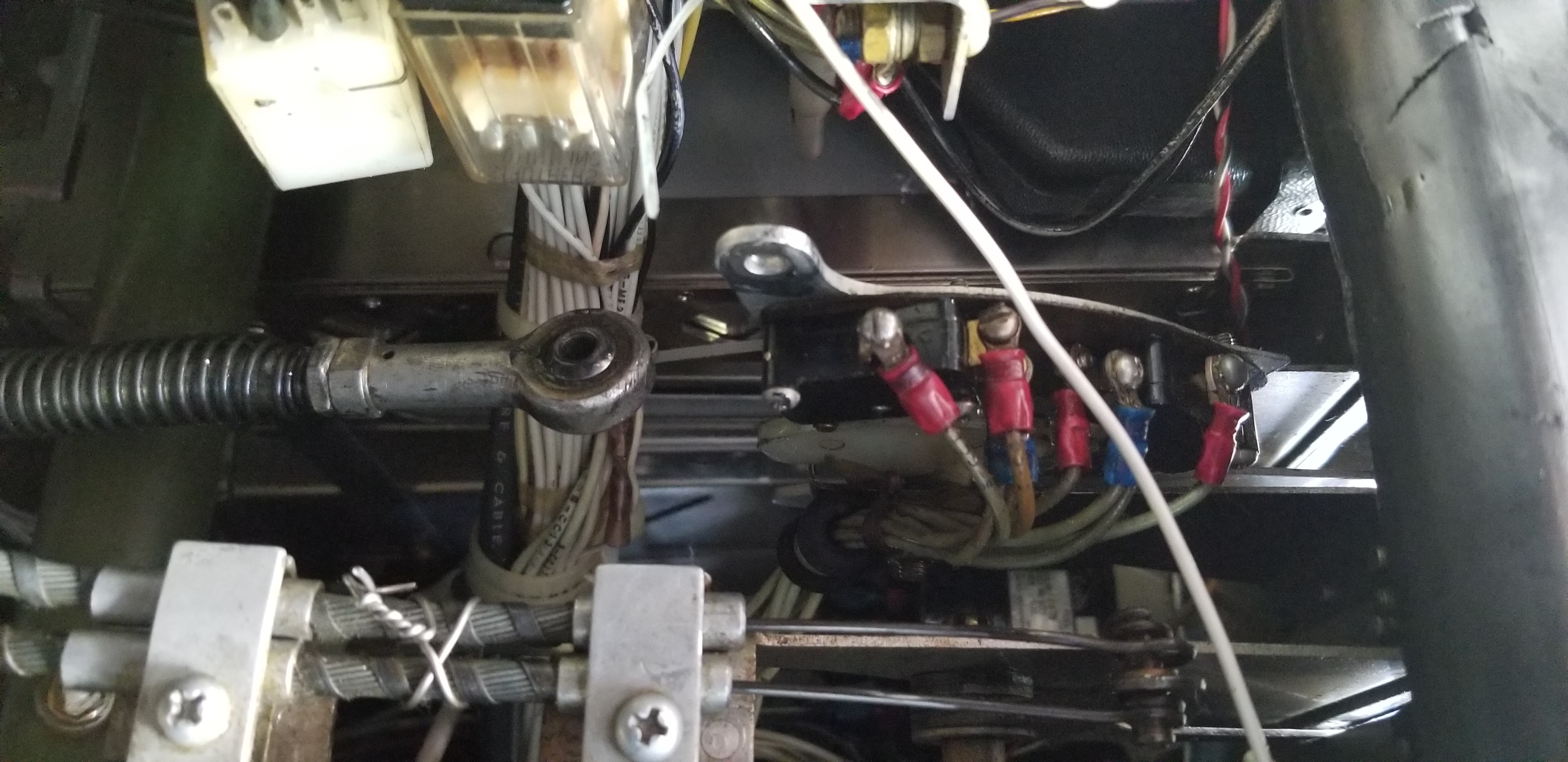

I got it figured out. The push-pull cable that attaches to the flap indicator was out of adjustment. The flap indicator interacts with two switches on the flap position selector. They both move, so its a fairly precise little Rube Goldberg mechanism. The push pull wouldnt allow the indicator to go to the full down position, which in turn caused a switch to not be pressed. I took some pics that I will upload later. Files are too big so site wont let me from my phone.
Unread 10-04-20, 11:46 AM

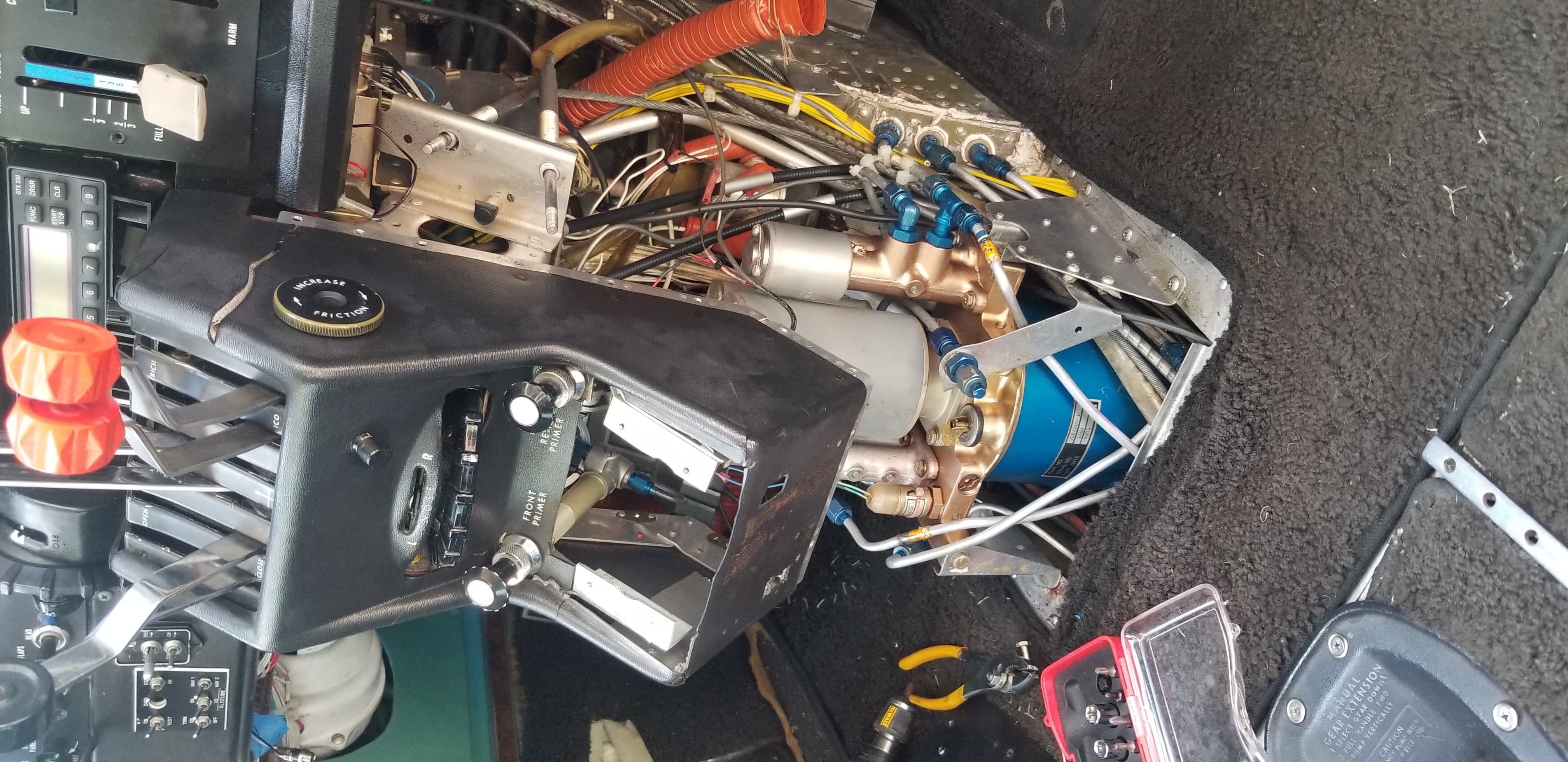

Pics attached. Had to remove the pedestal cover to access the flap selector switch. For pressurized models, you have to remove the dump valve t-handles and securing nuts before you can remove the pedestal cover.
