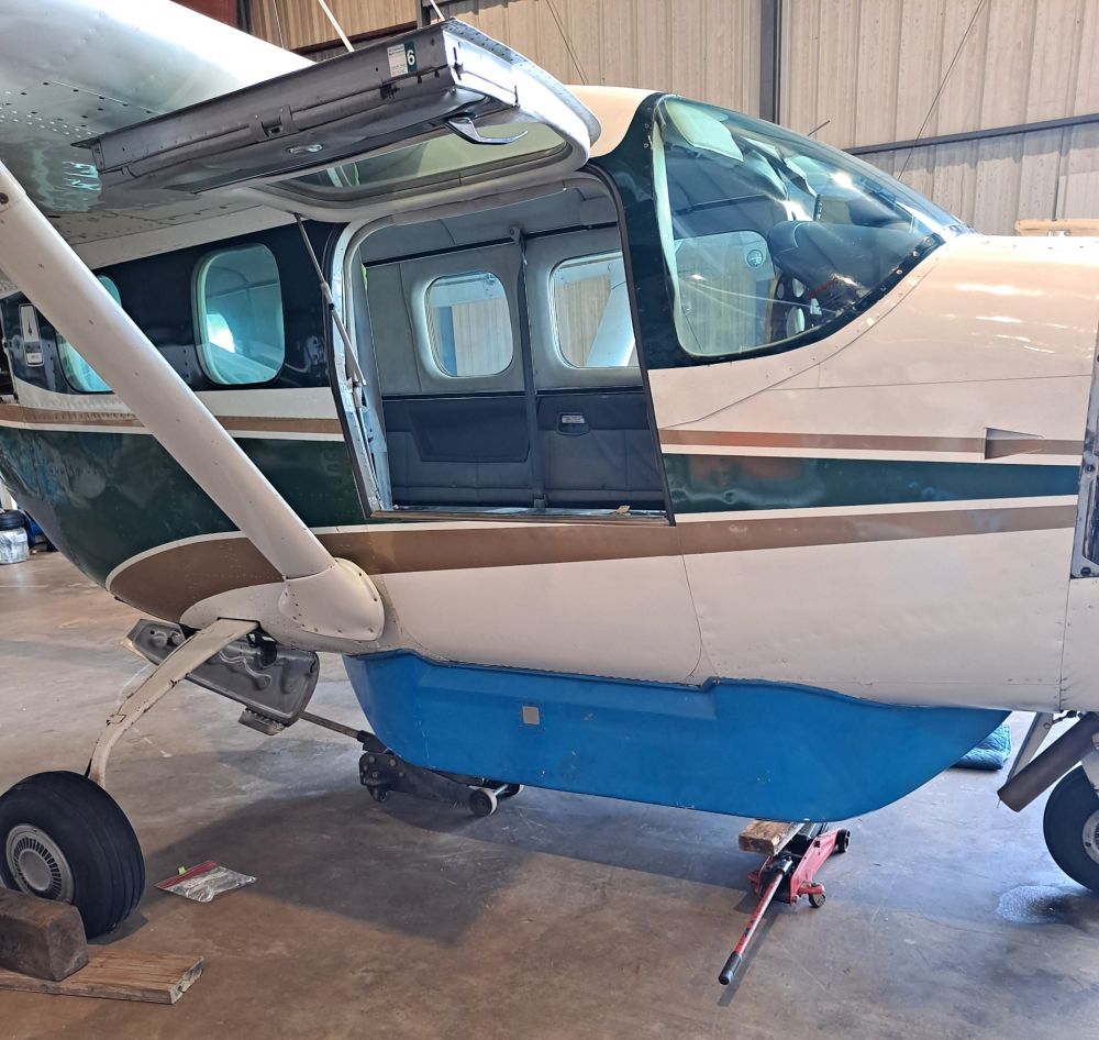

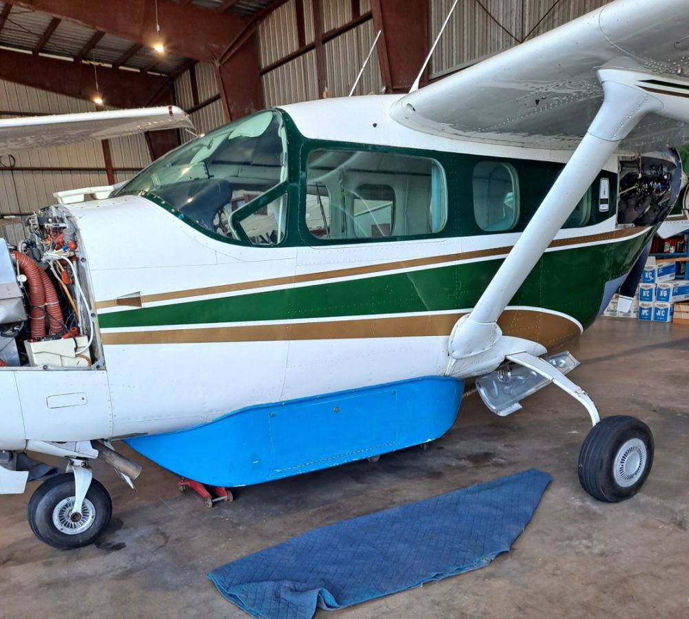

My airplane is in annual, and the pack is being installed. The pictures are of the pack being fitted before refinishing.

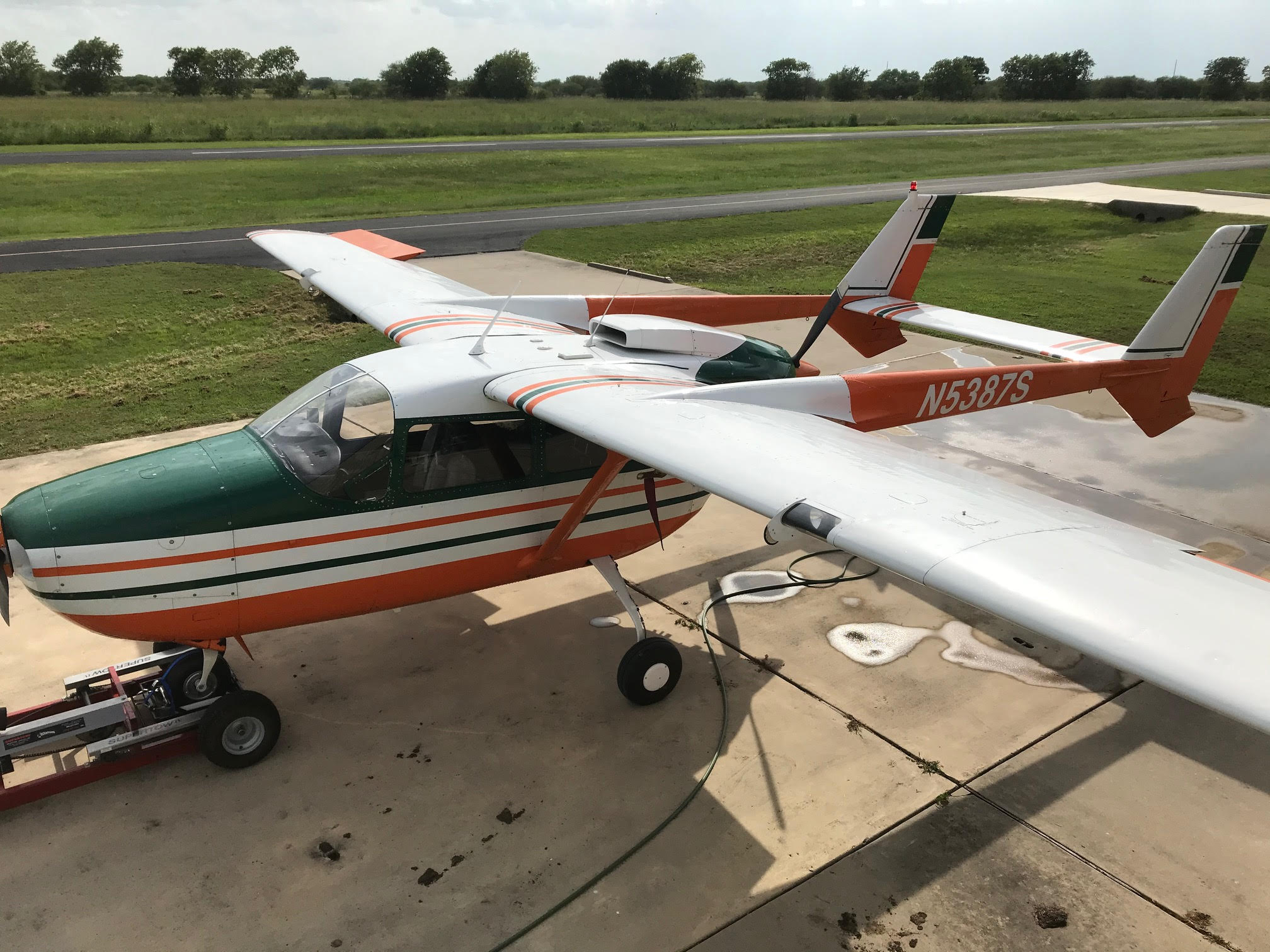

Antenna for WX-8
WX-8 Stormscope antenna is on top of my fuselage - see pic (big square one, port side, mid-cabin). Not sure if it works the same as Insight, but a quick test in the hangar is to use a hair dryer/heat gun or drill and see if it indicates (cheap motor arcing simulates lightening).

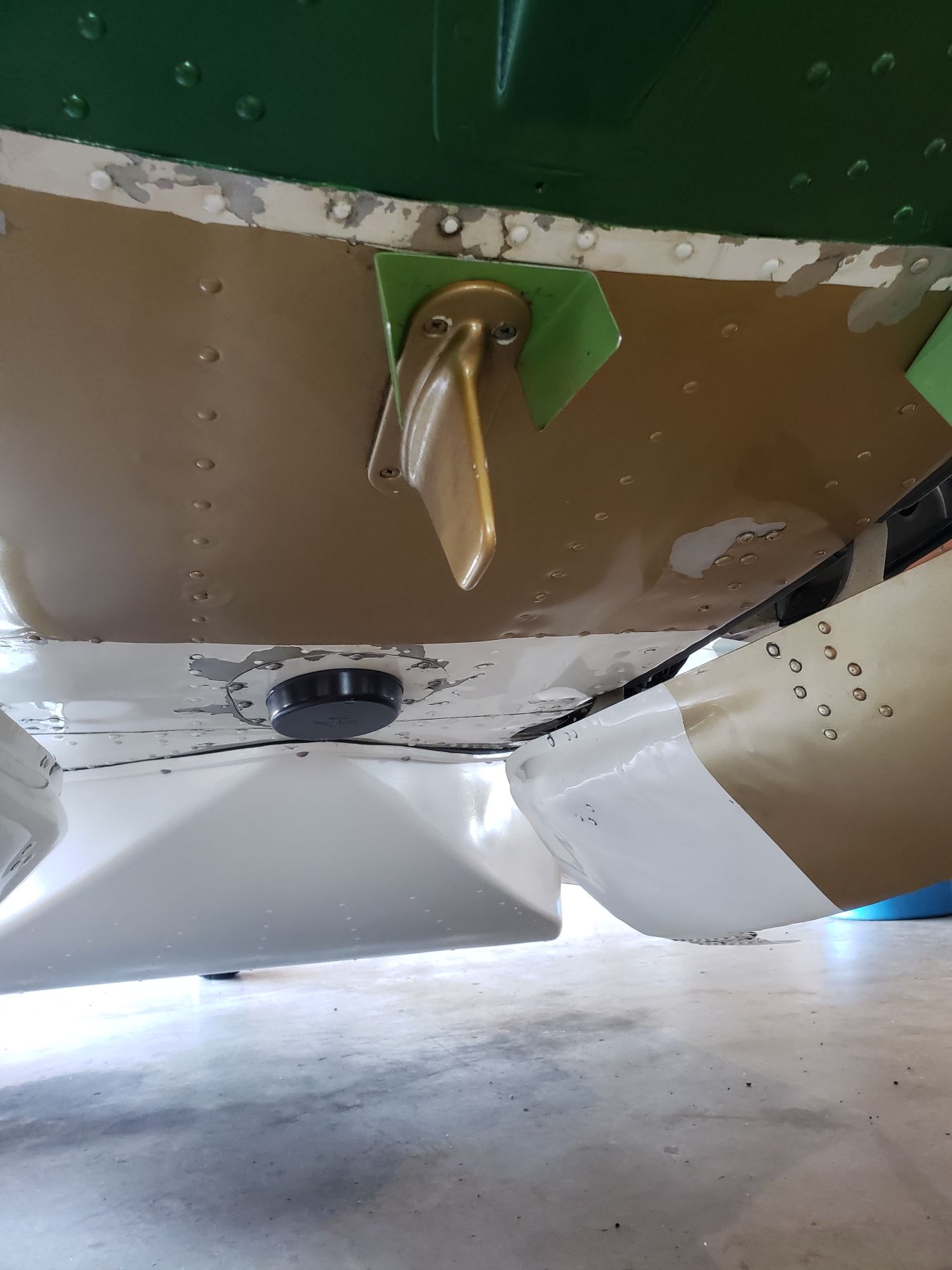

Providing follow-up on my topic. We did find the perfect belly location for the antenna. There is an inspection plate immediately aft of the pack.

A bit of follow-up concerning the location of my StrikeFinder antenna.
When I spoke to Insight, a guru said to put it on the bottom for optimum reception. He said in storm detection, and we forget a simple thing about a lightning bolt. The charge moves from cloud to ground, but the voltage of the strike is produced where the negative charge meets the positive (earth or another cloud). The greatest voltage, which a strike system measures, is at the ground during ignition.
The pack had been outlined on the airplane's belly, so the mechanic pulled an inspection plate off that was immediately aft of the pack; there was plenty of room, so a 15' cable was made and the antenna mounted on the plate. The image is attached to the post above.

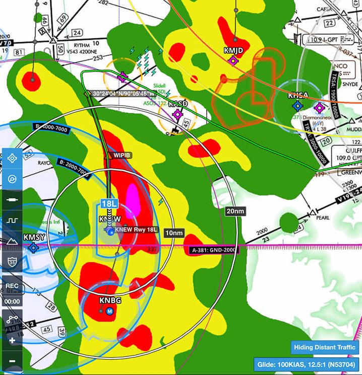

Last weekend was a proving run from my airplane, with a flight along the Gulf Coast to FL and back. The return, crossing from AL into LA, proved the SF installation was worth the thinking.

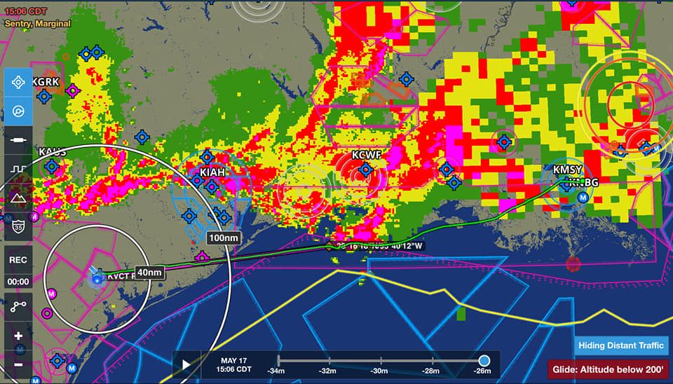

The SF (and approach controller) did a great job of presenting me with a path to join the approach. I have ADS-B In, like most, but you darn sure do not want to use it for this tight work. In the attached ILS image, the weather displayed is actually slightly east of the displayed position; the ADSB delay and the Insight StrikeFinder (ATC) confirmed the wall of the weather was just east of the final approach course.
The Strike Finder continued its good work with the flight into Texas. After that, I had to go offshore and then east. But, again, the SF helped me wiggle my way through the weather about midway rather than take a larger deviation further south.
