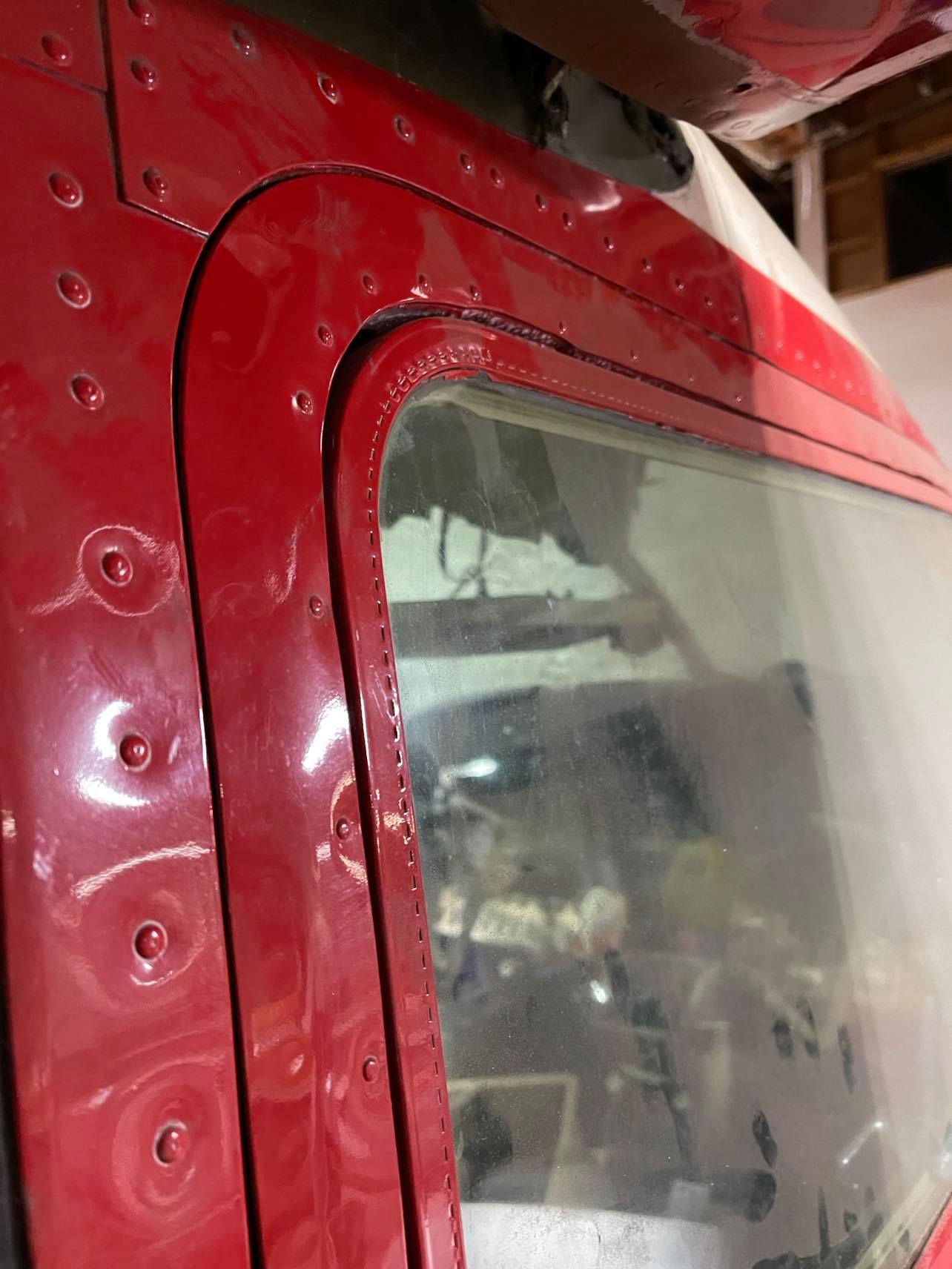

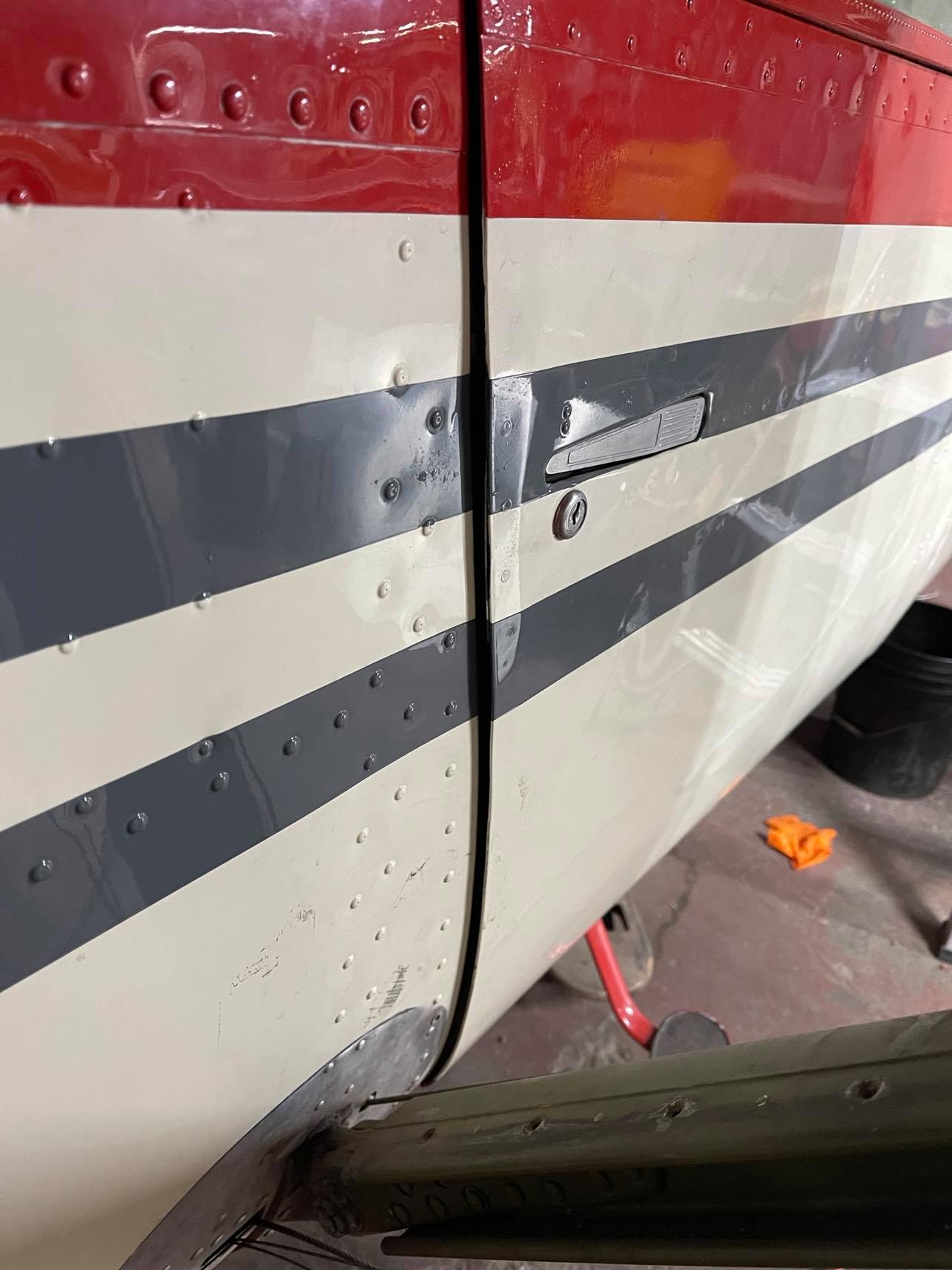

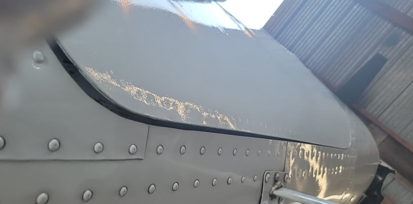

Does anyone have pictures of a door that fits with no gaps or is this normal for a 337
Trying to resolve this problem Was going to buy a used one but it also had a gap
Frank
1967 337B

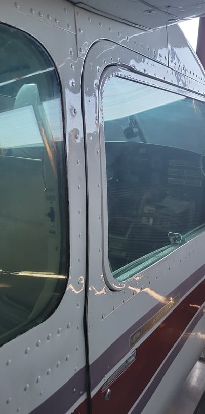

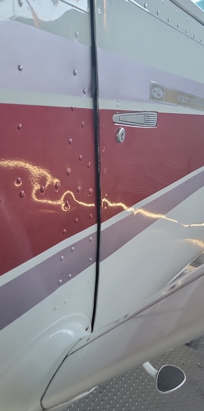

Here is a door I was looking to buy Same issue
1967 337B

Exclamation Latches are adjustable
That is not normal for a 337. My doors close and lock perfectly.
The key to solving your issue is LATCH ADJUSTMENT. I learned this working on a 172 door. The latches have an adjustment capability, and this simply appears out of adjustment. Check the service manual for procedures, but this is something that could be fixed quickly by someone with experience. Flying a P-model as I do, its critical that the doors close properly.
