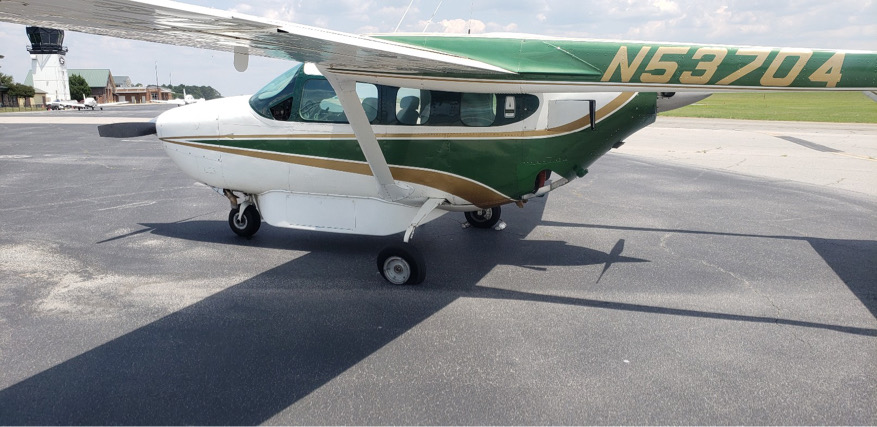

Glad those gear doors/speed brakes didn't get you Patrol Pilot! Do you have the gear door delete STC? If not, would you consider it?
Unread 04-22-22, 06:47 PM
Purchased the gear door removal STC immediately after the second event, then had it installed at the next scheduled maintenance interval.

How the H*LL did you just post an inline photo???????? That is SWEET!
Did you notice any performance changes after the STC install?
Were the labor hour estimates accurate?
Somebody needs to design an STC whereby the main gear doors open to their "speed brake" position when you need to lose altitude without shock-cooling the engines...
Unread 04-22-22, 07:51 PM
Dude, I learned how in a topic you started! Making photos appear in posts
No changes at all; aerodynamics, noise, nothing.
Mine took the high end.
That sounds spooky to me!
