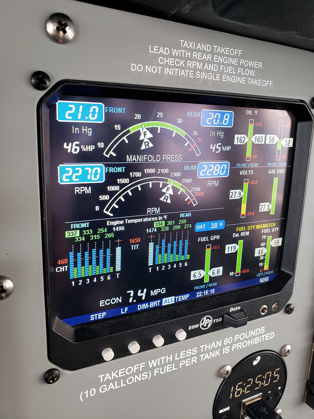

Tangentially related, anyone else try seeing what the minimum possible fuel flow while staying aloft is for your plane? I needed to build a bunch of hours for insurance reasons while not going anywhere in particular very quickly, so I spent some time playing with this and got it down to about 12.5 GPH total (10500', 6.5 GPH front, 6 GPH rear at about 21" and 2250 RPMs). Couldn't get it much leaner without intermittent missing. 1975 P337G, no GAMI injectors on here. Photos attached showing EDM-960 display and airspeed.
Single engine with the front prop feathered at 10500' (while loitering over a rural airport with a 5000' runway) actually took more GPH to maintain altitude than with both engines running.

That's good info on the min fuel flow. I see you were doing C172 type speeds but with an extra 50% fuel flow (vs the 8 gph of the 172).
I have the EDM 760 FF gauge installed. My understand is the 960 is a plug-and-play replacement for the 760 (won't fit in the same mounting spot though!) I think with trade-in, the upgrade only costs about $1500! I would have already done it, but it would require almost a complete redesign of my panel, so I've held off. Would LOVE to have one though!
I bet you could cut it down even more by caging the front engine. I hear that the Skymaster is the only airplane that EXTENDS its range when operating on only one engine!

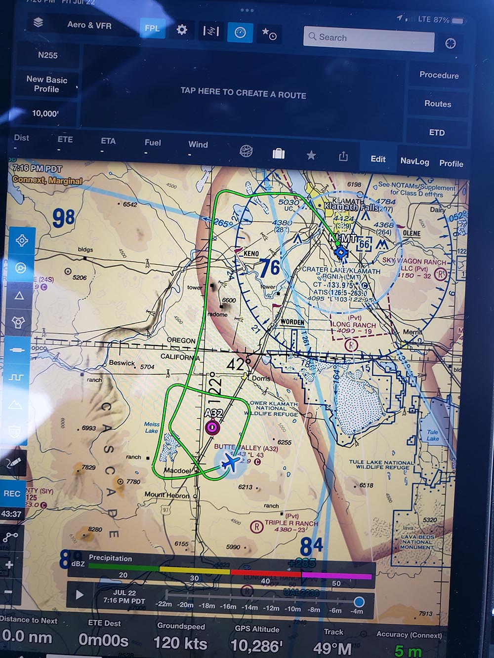

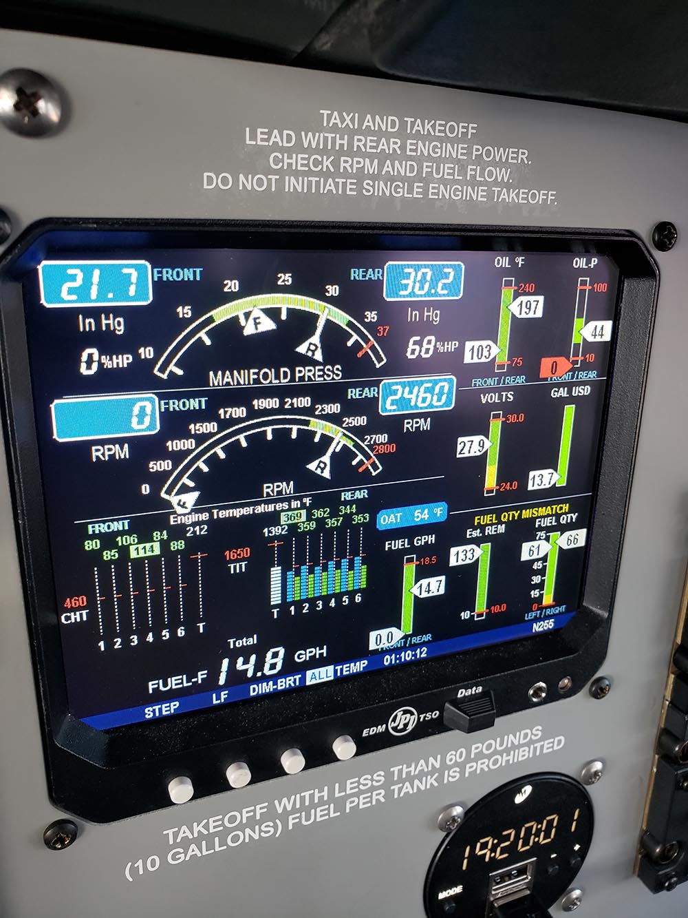

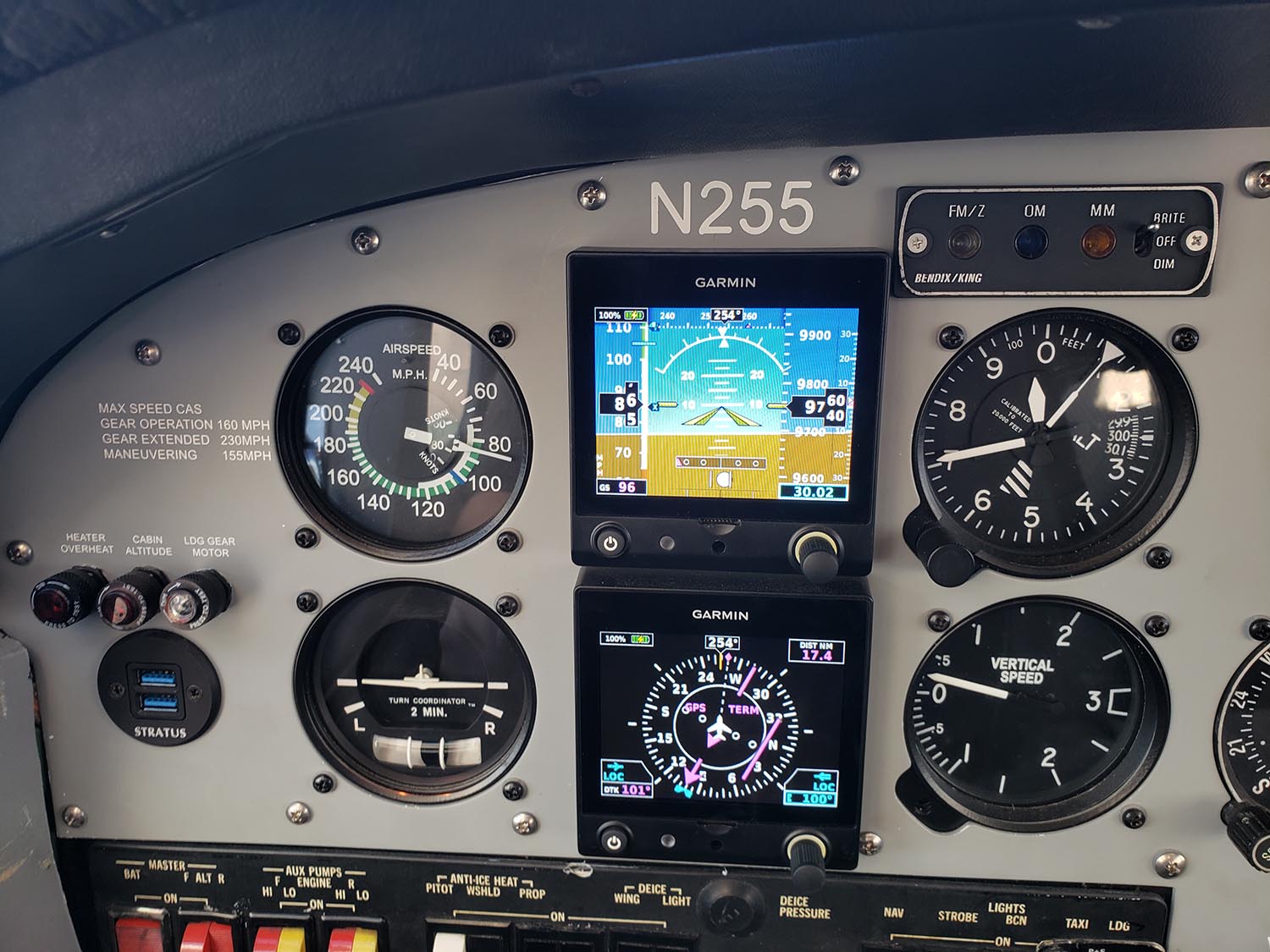

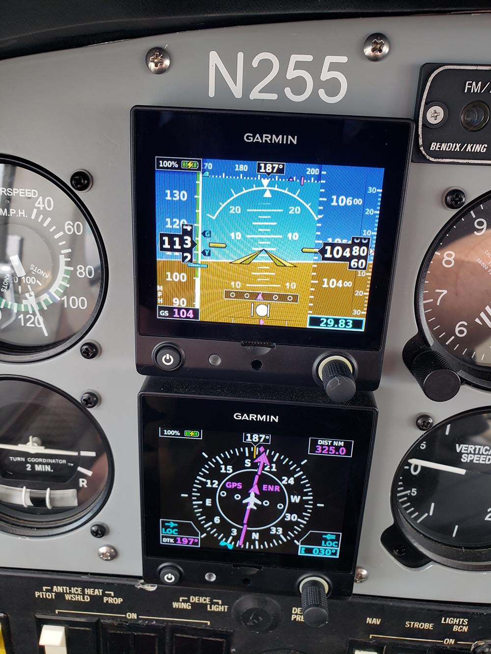

Found the photos from my single engine minimum fuel flow test. Photos attached, looks like I ended up at 14.7 GPH on the rear engine to just barely maintain altitude close to Vx.
I'll try it again during the winter months sometime soon and see if I can get it down any further with cooler air available. And maybe see if I can maintain altitude at Vy for a little less drag.
