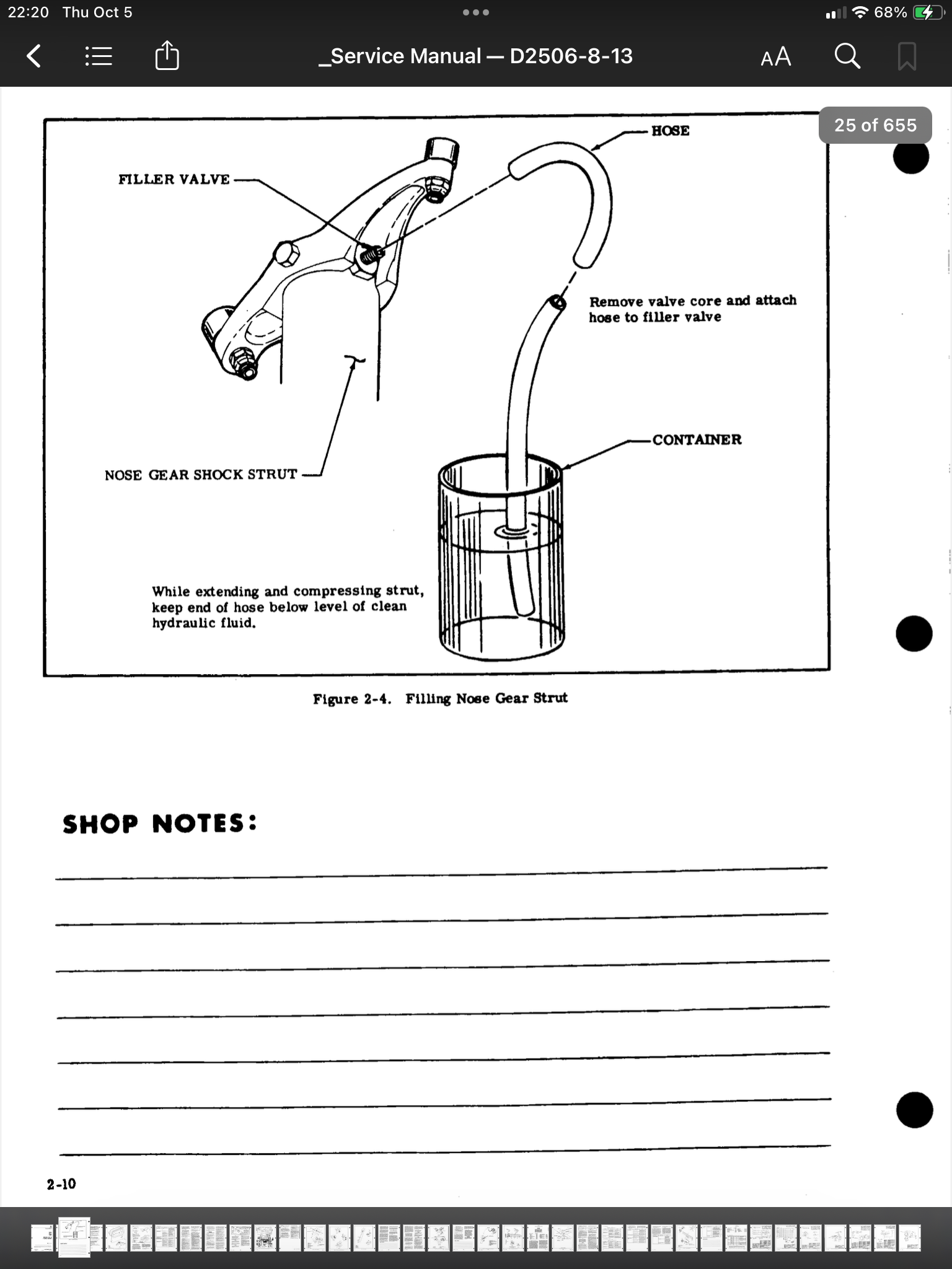

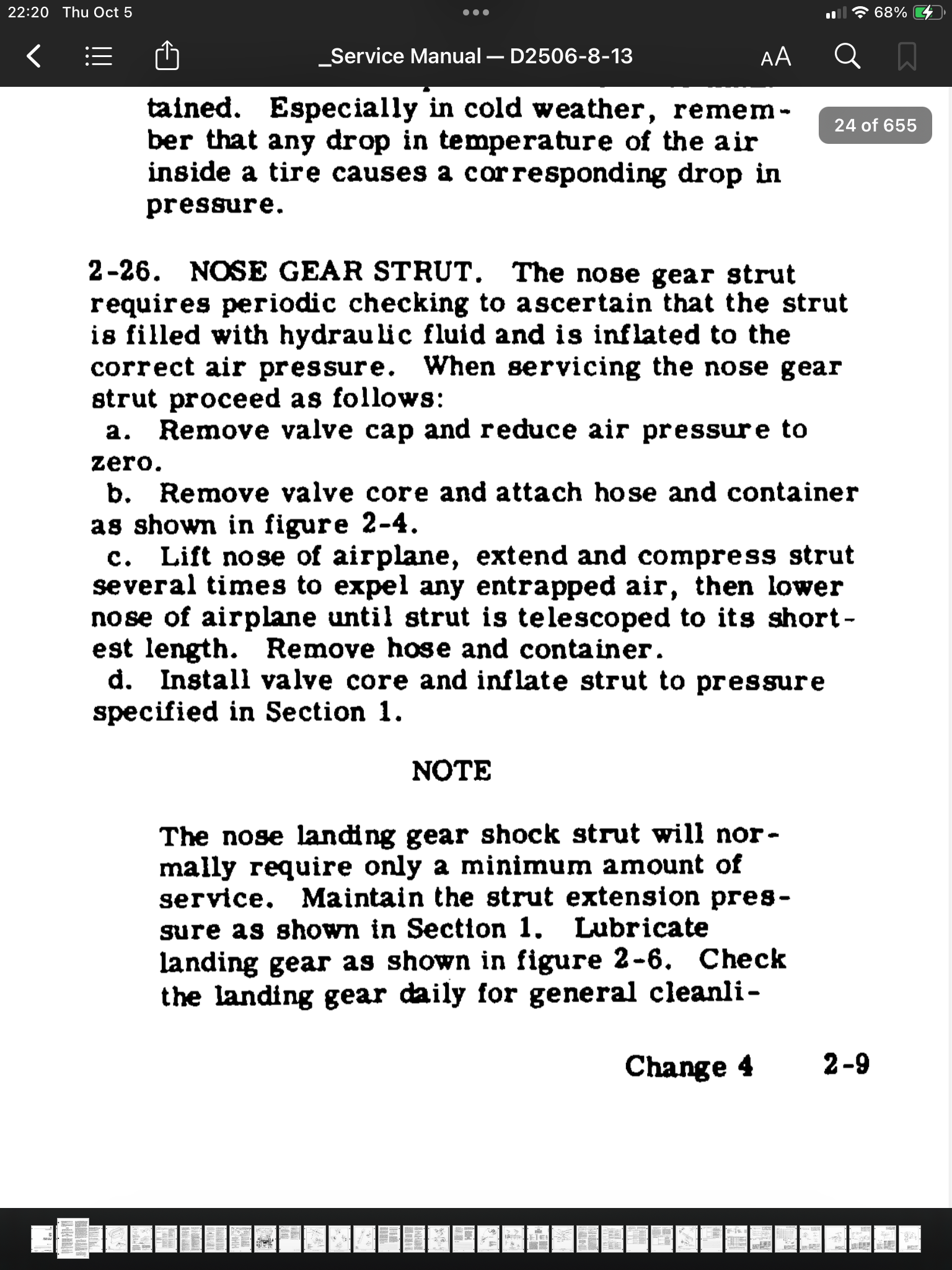

I would not recommend flying with a deflated nose strut.
On my G-model, the nose strut pressure specification is 35psi.
The procedure is pretty simple. I’ll try to post the pages from the g-model service manual. Nitrogen is best but air works too.

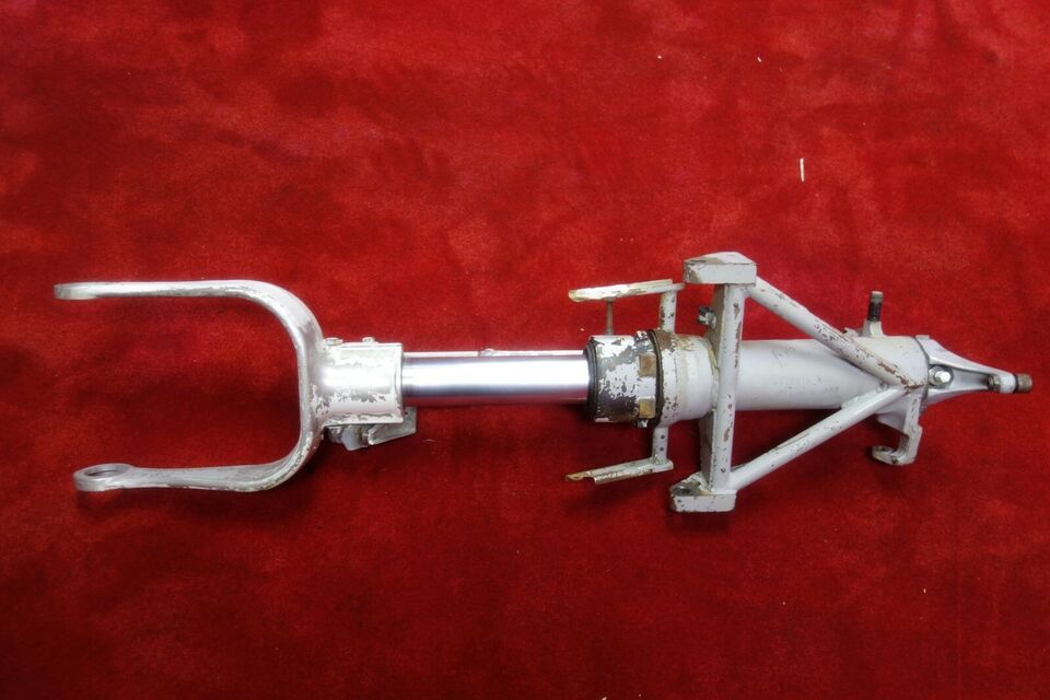

My mechanic filled it while I pulled down the tail and rested the tail on a upside 5 gallon bucket with a pillow on top of it. The nose gear was down and locked while he filled it

The cap on the valve should be able to be loosened with your fingers
You can see it in the picture attached
Frank
