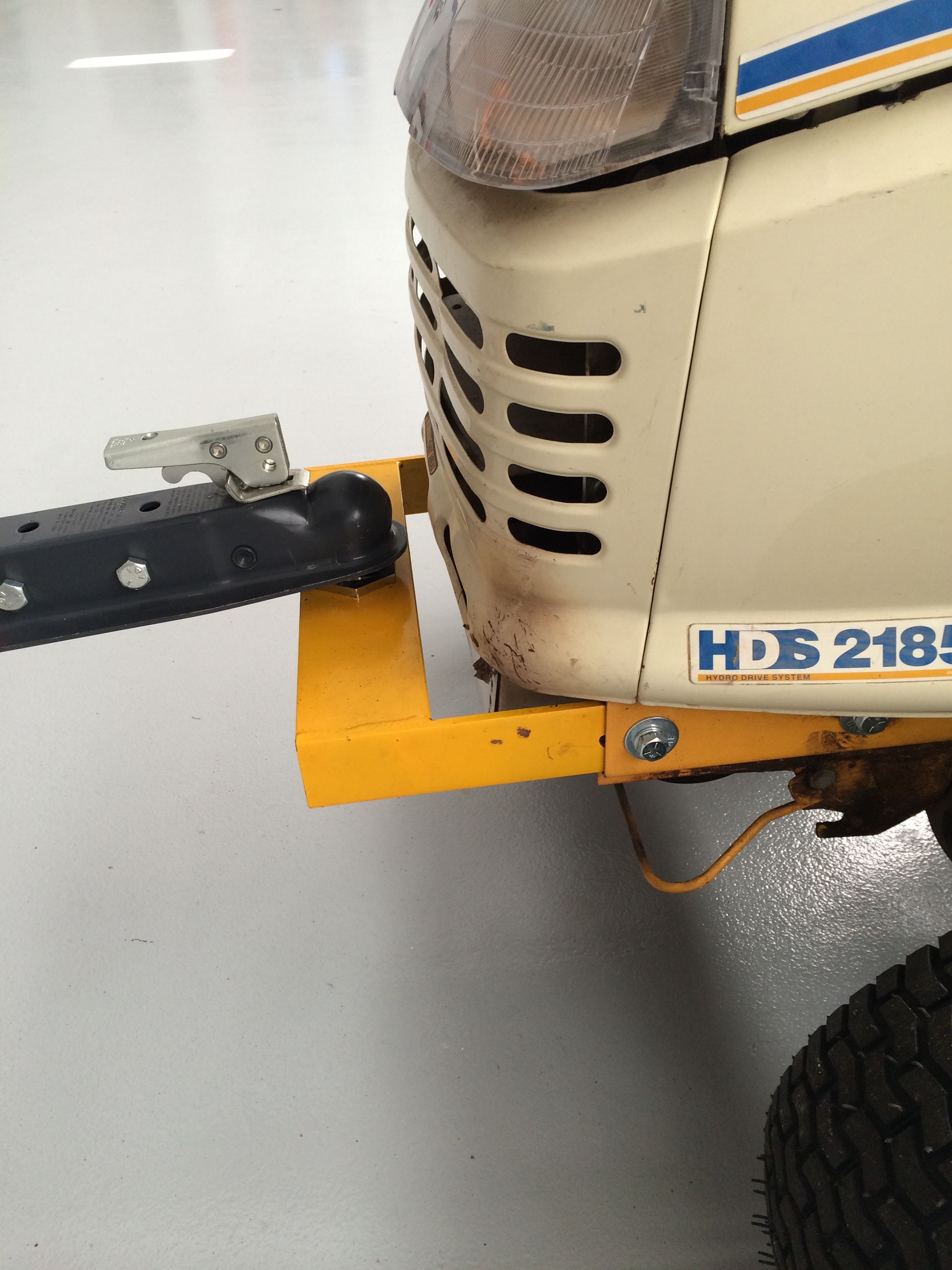

I had an older lawn tractor that I wasn't using any more so I made a bracket for the front. Works great and only cost about $60. There's a ball on the rear, too.

Here's another picture showing the Bogert tow bar. Easy to attach and remove. Notice the Fun Noodle Prop Protectors. My mechanic loves them!
