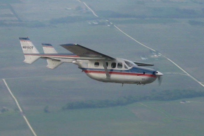

I am trying to locate information and photos of the various STOL kits available on the Skymaster. I have a 73' T337G w/ Deice boots and pressurization. After some reading, I realize that I am limited on my options as a result of the boots. I would like to learn more about the various STOL options. Any pictures you may have of your STOL would be greatly appreciated!
I have attached a picture of my skymaster..

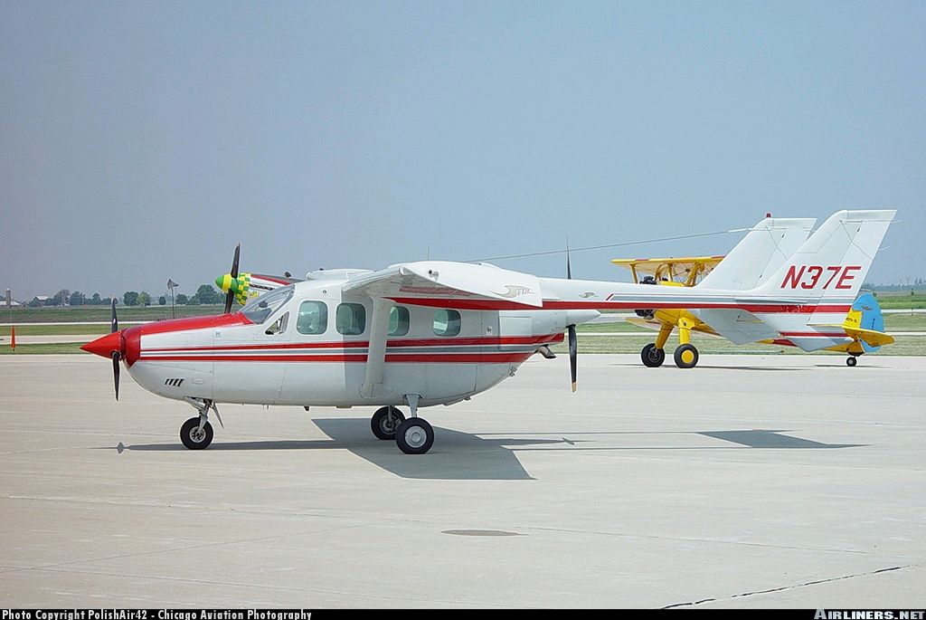

The Horton kit consists of wing tips, a leading edge cuff, and about 5 big VGs located under the rear cowl. I have the little "fence" just inside the aileron, too, but I don't know if it is original or part of the Horton.

Pat:
Here is a picture of my aircraft. I think you can see the leading edge cuff, and the wing tips and rear cowl VG's are easily visible. This is what the Horton STOL looks like.
Mark
