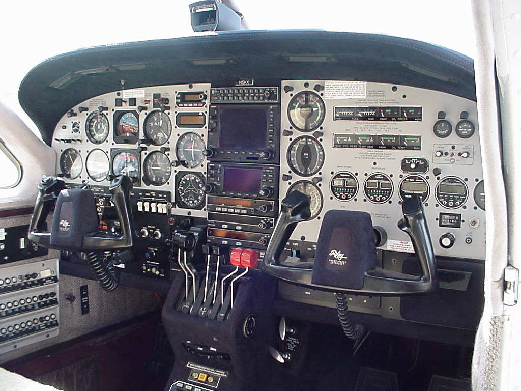

N5KX has a Shadin fuel flow as well, and individual digital engine gauges. But it also has a digital tach, brand unknown until I go to the airport. When the props are synched, the front and rear RPM's are exactly the same on the digital tach, even though the standard tach shows them a couple hundred RPM's apart. I have attached a picture, but the digital tach is behind the right yoke and not visible.....

That's a nice looking panel. Unfortunately I am out of real estate on the panel. I need to eliminate the original fuel flows and tachs in order to put in the digital gauges.
I'm looking specifically for Replacements rather than additional gauges.
There are several of them which are probably better than original equipment. The issue is gettig rid of the original ones.

nice panel!!!
