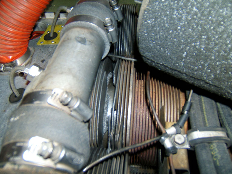

Unread 08-06-06, 05:41 PM
Here is the cylinder
Unread 08-06-06, 09:34 PM
Herb,
Good Picture.
Not as bad as I imagined. This ought to be an easy fix, just replace the cylinder. It looks like the piston is contained, you shouldn't have any spare metal pieces in the pan. Let's hope that is the case.
