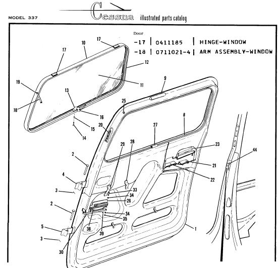

Pictures of older 337's, ie 1965-72, look like the right passenger window opens as well? Can it, too, be opened in flight?
Unread 08-10-11, 10:00 PM
Yes, but perhaps not all the way up. Attached is the image of the door of a 65-69 from the parts catalog, with two of the parts identified (I used to have a 69). I believe that the arm (part 18) limits travel, and also that 73 and later have a sufficiently different fuselage that you couldn't just put this door in a later model. Don Nieser could confirm this.

If anyone has one of these windows, is there room enough to stick a camera lens out? Have you opened it in flight (would be slow flight for the photo)?
