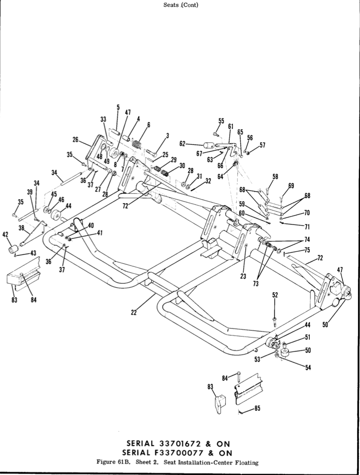

We have a 1973 P337G and would like to have sliding rear seats. Is this possible and does anyone have any information on what is needed to accomplish this?

I don't know of any STC for this but you might contact Aviation Enterprises or RT Aerospace. I would guess that if you found parts you could request a field approval as none of the '73 models had the cabin side seat rails.
Looks like the floating center seat started with serial number 1672 for the non-pressurized version
