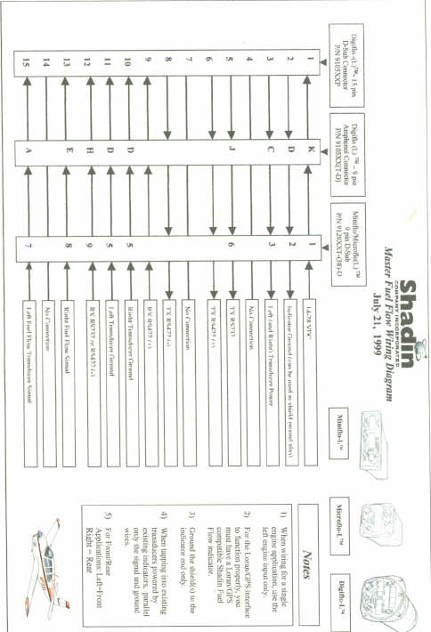

shaddin finally got back with me and e-mail a trooubble shooting guide plus wiring diagrams. if anyone wishes this info send me your e-mail and i'll attach it back to you(haven't figured out how to do any atchment from this spot.
rick
Unread 05-22-02, 08:11 PM
Ron Ball Ron Ball is offline
Posts: 24
Ron Ball is an unknown quantity at this point
Rick, my e-mail is rball@goodmanball.com. I fly a 1973 P and a T-337-B 1967 Would like the data
Unread 05-23-02, 12:00 AM

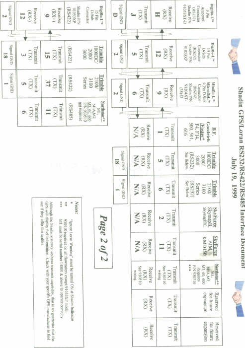

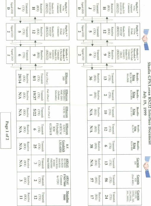

i just emailed webmaster with the (3) pages to post. not real bright at making attachments so i used three mailings (my be better if he post it. if you want me to try, let me know and i'll try emailing you. same type 73p337
Unread 05-23-02, 12:04 AM
The following 3 messages are Rick's 3 files...
First page:
Unread 05-23-02, 12:08 AM
Actually, the board software noticed that two of Rick's files are identical, so there is just this 2nd attachment:

Another page from Rick
Unread 05-23-02, 10:41 AM
And another page from Rick. Total is four now.
