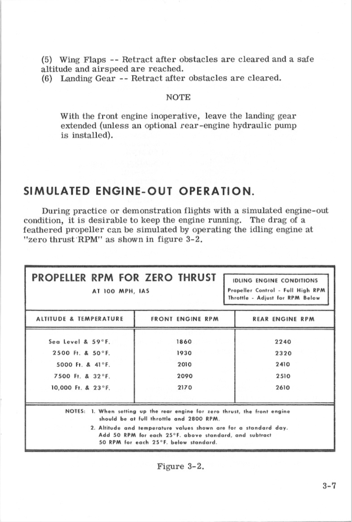

Frank or anyone. Any chance you could send me a copy of the "Zero Thrust" portion of your AFM? Appreciate it.

Zero thrust attached
Accelerate Stop - don't go there as it is not published
