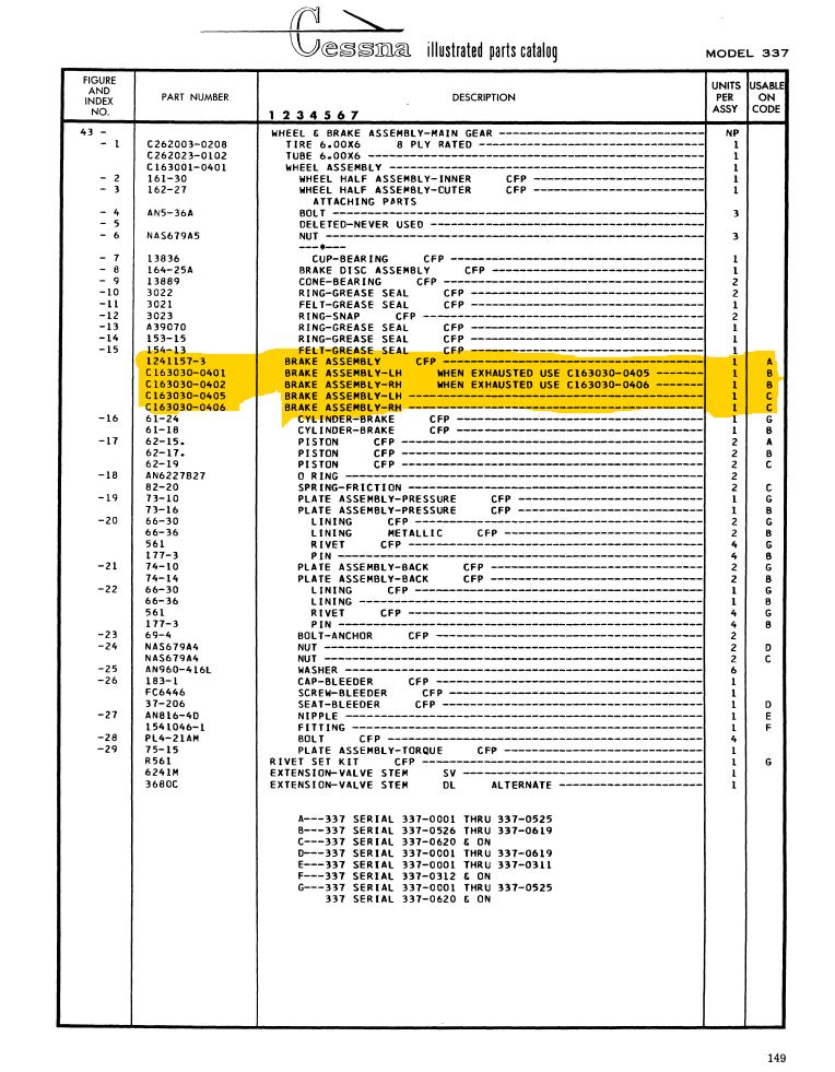

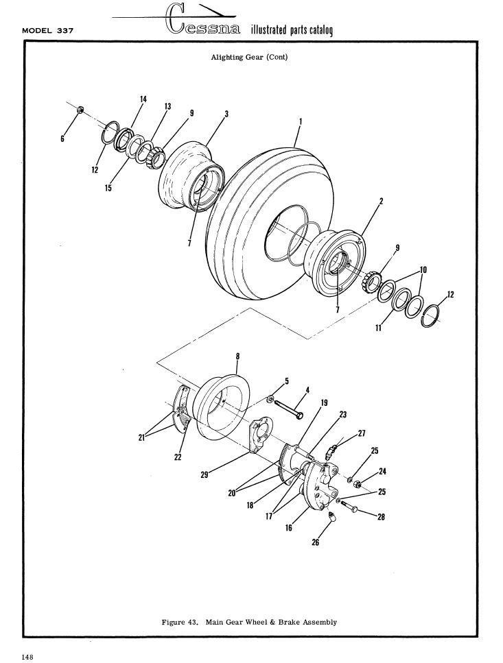

Brakes
YC,
I think practically - the later model brakes should work - it looks to be the same torque plate and brake disk assembly for the various models. As you can see, there are different P/N/s assemblies for the brake caliper assemblies themselves - but the structure they attach too and squeeze are all the same.
Practical is always different than approved...

Thanks Jeff. I noticed the "when exhausted" part you highlighted there. So seems to indicate that you can upgrade, and are essentially directed to do just that. Am I reading that wrong?

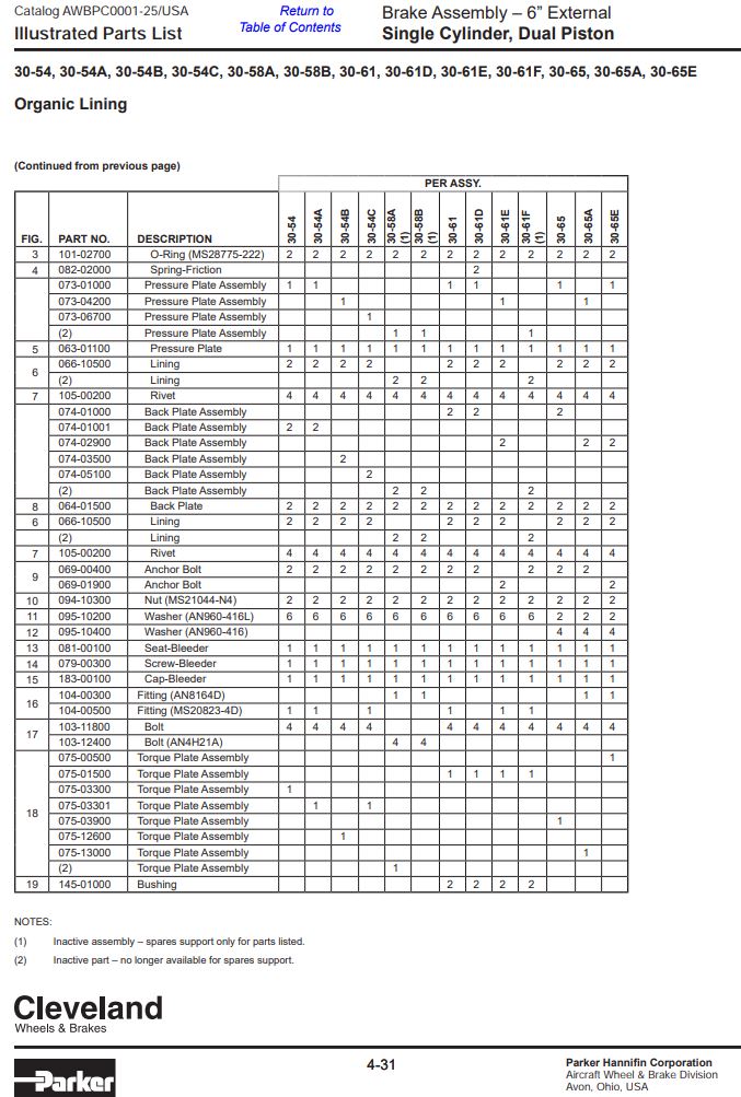

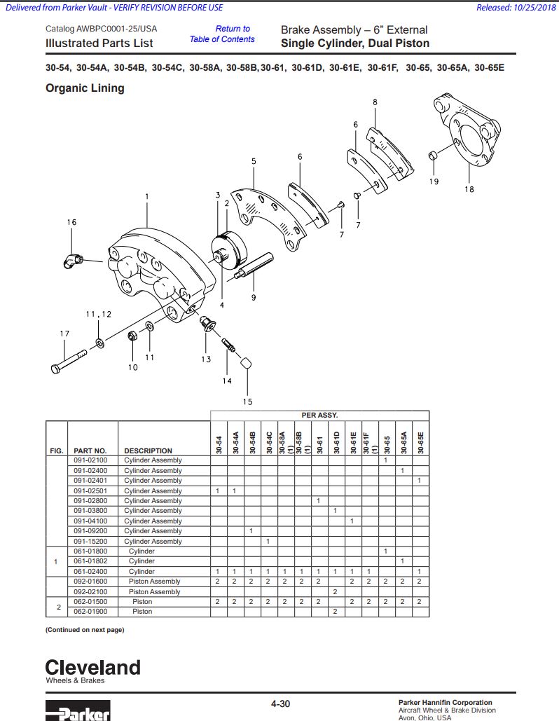

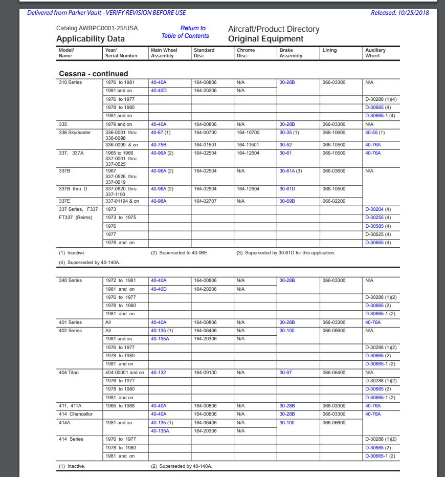

Gray,
You are reading that correct - however you have to look at the applicability code for your serial number aircraft. If you are S/N 0001 thru 0525, your brake P/N is only 1241157-3. If you are after S/N 0525, then there are some options on the brakes once exhausted.
All that being said, physically, they are all identical. As near as I can tell, the 1241157-3 is a Cleveland 30-61 brake assembly. The B model and later with Brake C163030-405 is a Cleveland 30-61D brake assembly. I have attached the pages from the Parker parts breakdown, and the only difference I can find between these brakes, is the pistons are different (same size though) as they have a little spring on them. There is no difference in sizes, brake linings, etc, so my assessment is that there is no performance difference in these brakes, other than a small improvement on the piston to help keeping them from sticking...maybe?
