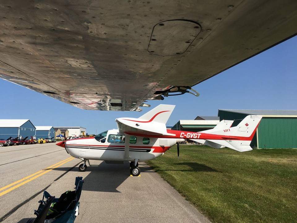

Here is a picture of a 77 337G Skymaster II with complete Horton kit installed on it. Wing tips droop plus have formed winglets on them.

The winglets are not part of the Horton STOL STC.
