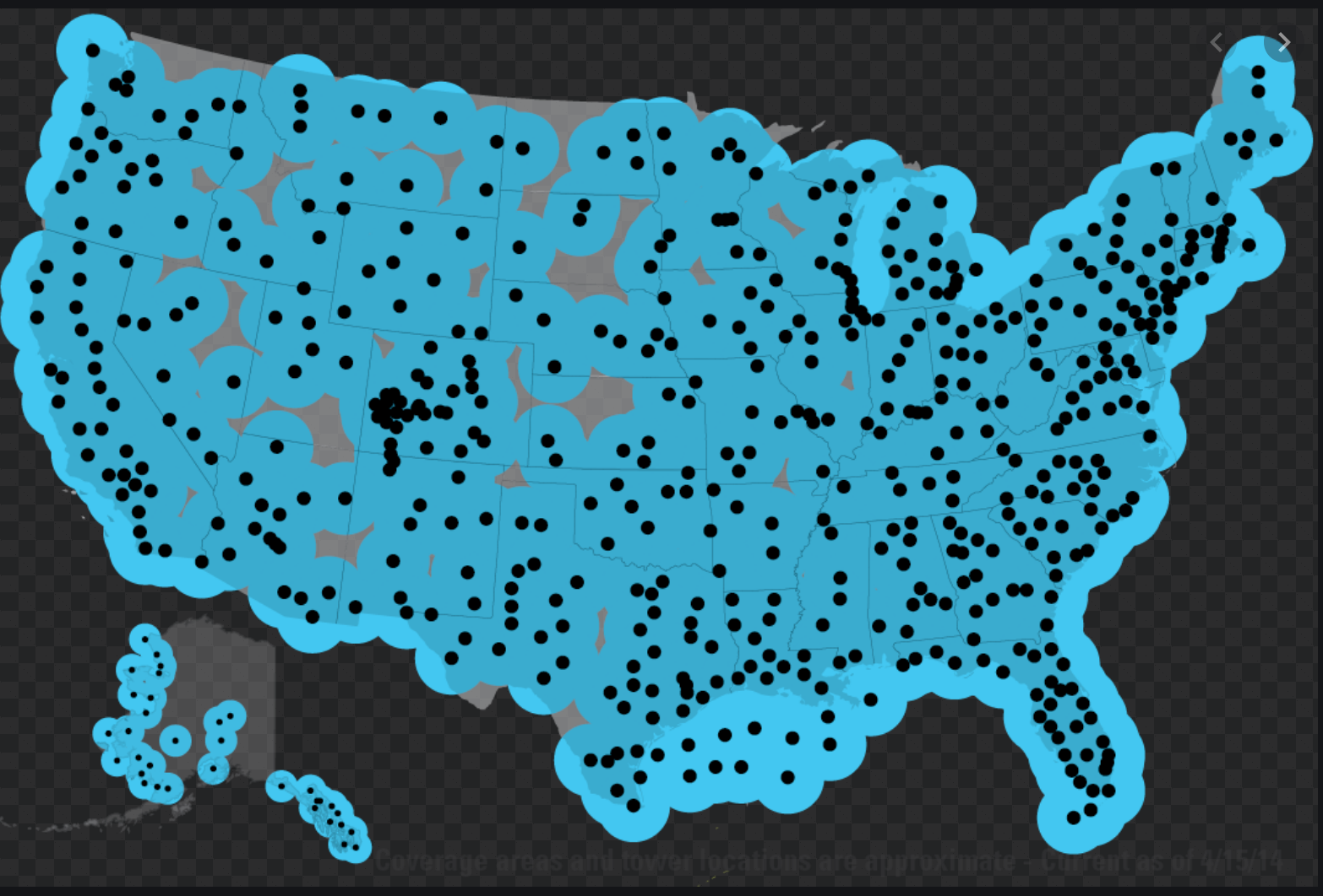

ADS-b covers almost 99% of the US, vast swathes with no ADS-b? Maybe if you live in Alaska

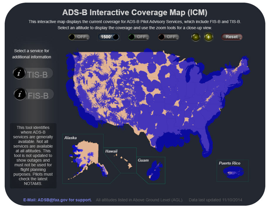

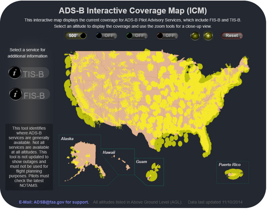

That depends on at what altitude you are flying. On an approach below 1500 feet you may not have ads-b coverage. I have attached two screenshots from the FAA ADS-B webpage showing coverage at 1500 and 500 feet AGL.

Ok, I see where you are going with this. I wasn't thinking about the lower altitudes that would be obscured of receiving the 978 UAT transmission. Although it's always nice to be able to know about traffic, the areas that may be obscured are really going to be low volume traffic areas. Most busy traffic locations appear to have coverage. It's easy for me to say as I am now a flatlander pilot and have coverage nearly 100% of my area. Point taken, thanks Ed
