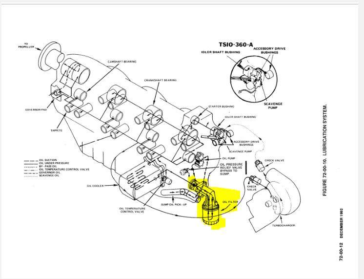

That occurred to me. but I don't think the filter can hold 2.5 qts of oil, can it? Also, I checked the TSIO360 engine manual, and it shows the oil filter adapter and oil filter as original design equipment. By 1978, I believe Continental was putting oil filters on most engines from the factory.

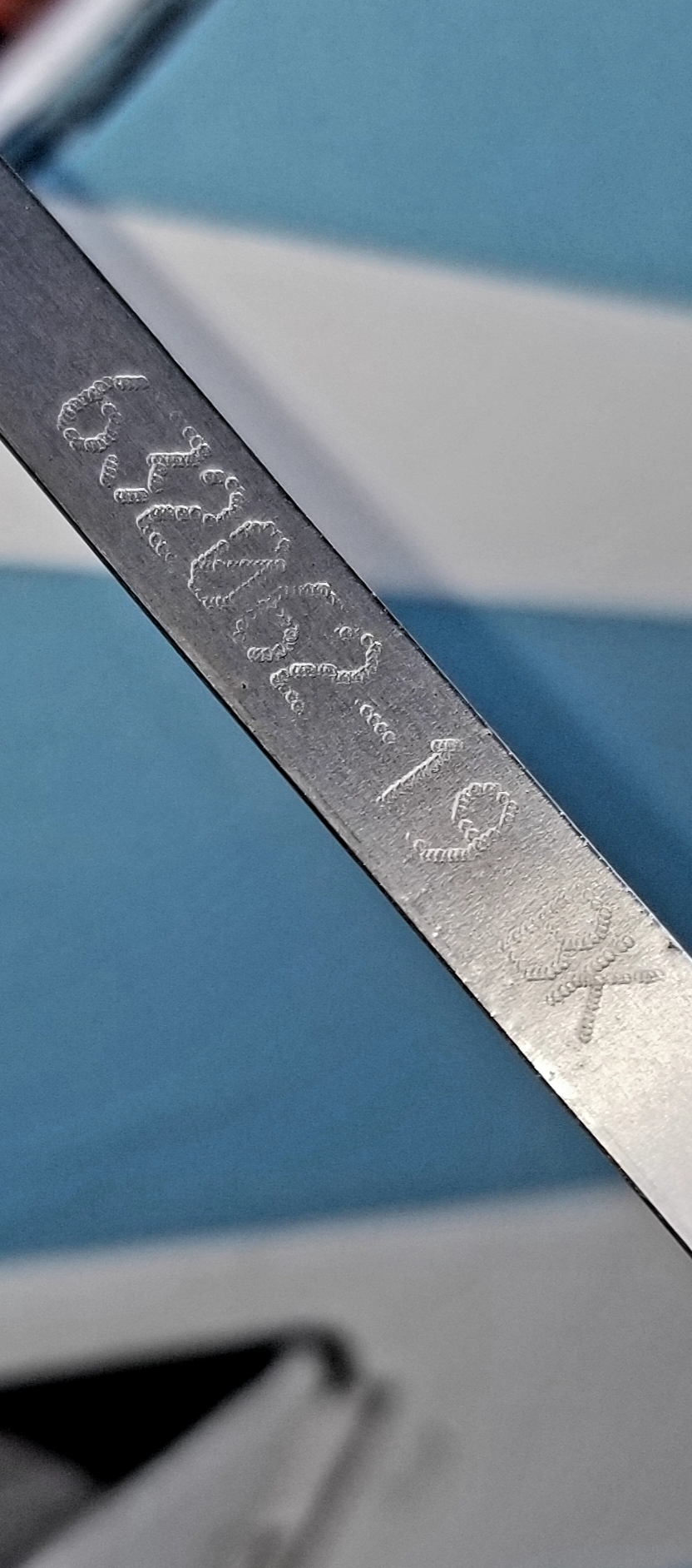

Thanks Kim. The rear engine is a TSIO-360CB-6B. The dipstick currently installed is a 632062-19 BK. Photo attached.
Unread 09-15-20, 10:23 PM
Location: Bahama, NC
Posts: 305
That should be the correct dipstick
What I do is after an engine change at the first oil change I’ll put in 8 quarts and scribe a mark On the dip stick. It is always 1/4 inch below the 8 mark on the stick. The pilots run the engines at the scribed mark and the engines don’t seem to blow any out. Then at oil changes I’ll put in 9 quarts and after the run up the level will be at my scribe mark. 1 qt. goes in the filter. It’s the same on all 5 of our 337’s
