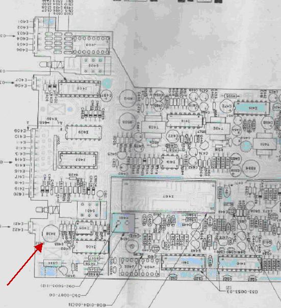

KX155 Display
Here is a pic of the main PC board. The display intensity pot is R438. It's the one with the red arrow. Be sure to observe all regulations concerning avionics maintenance!!

Smile Thanks
Thanks for the information, Sten. I promise to be a good boy, or at least have a good boy check behind me before returning it to service.
