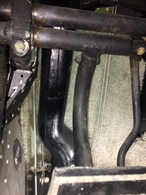

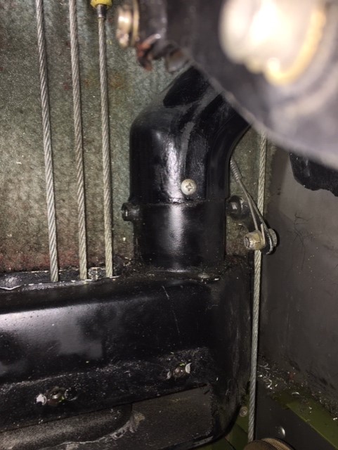

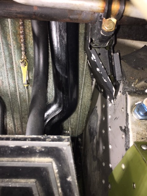

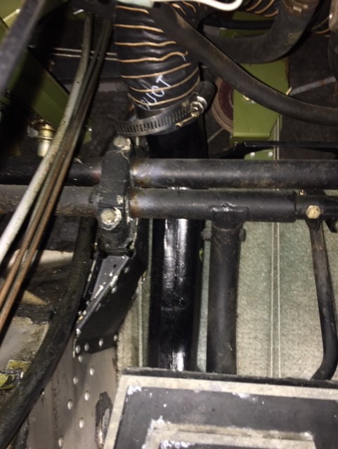

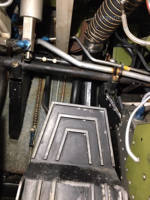

I have attached photos of my routing of the defroster tube and scat ducting. At least I hope I have successfully attached the photos. If not, basically the scat tubing goes behind the crossover linkage/bar for the rudder pedals and brakes straight up to defroster duct. I have a rigid tube that runs behind the crossover linkage but it is same diameter as scat tubing so scat tubing should be able to made to work.
