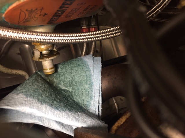

Okay, let me add one more thing. I promise this won't be wacky like the copper line mistake. We developed a small collection of oil in the center bay of the floor under the gear actuator. The oil would also drip off the left gear leg door if it was left open. I put towels under the motor for a couple of days. After two days the towel under the sump quick drain was wet. The oil was running off the sump drain and down the inside of the lower cowling into the belly.
I tried to attach a picture. Hope it works.

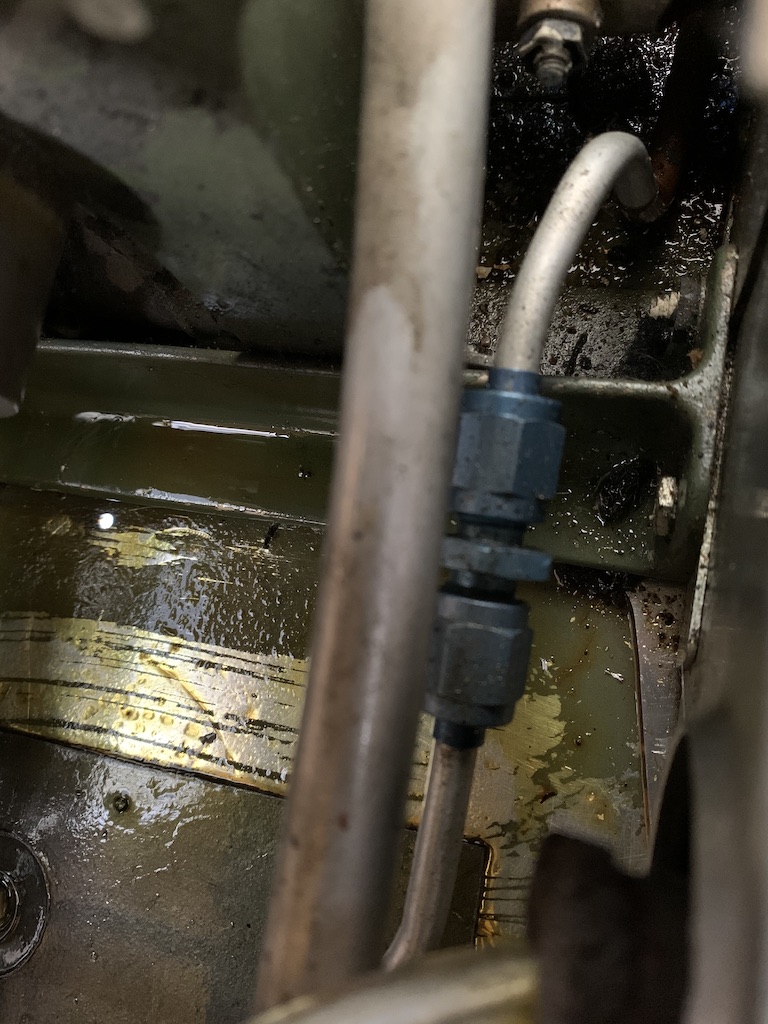

Picture of oil and area
Here is a picture. It's not oil, it's not 5606, it's not fuel. My mechanic's theory on the hydraulic fluid disappearing after the power back overhaul was, air bubbles were stuck in the system and as the gear was cycled the hydraulic fluid needed filling. The hydraulic level has stabilized an I have not added hydraulic fluid in quite awhile. He may be right. I don't know. I appreciate all the input. Please keep it coming.
Unread 03-12-20, 03:52 PM
Mystery Fluid
Based on the picture - it sure looks like engine oil...if not pin hole in pressure line, then it is breathing out of front engine or leaking like Dr. Dave's issue.
Is it sticky? I have seen old contaminated 5606 (Hydraulic fluid) take on a yellow color before...very rare but it can happen. OR - Did someone put a different fluid in your brakes?
I have personally just purged my brake system after resealing my brakes and installing new flex lines. I have one of those brake bleeding pressure pots from ATS, and I took a polyFlo fitting and screwed it (pipe thread) into vent hole on the top of the master cylinder. Off the polyflo fitting I attached a length of polyflo tubing into a container, and just pushed fluid up from the brake bleeder through the system with the ATS pressure pot. This flushes the whole brake line from the bleeder to the master cylinder. Once the fluid ran clean and fresh, close it all up and your system is clean, filled and bled all in one shot.
The area you have the fluid is coincidentally where the swivel fitting is for the brake lines.
Let us know...
