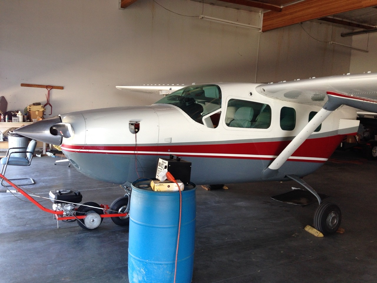

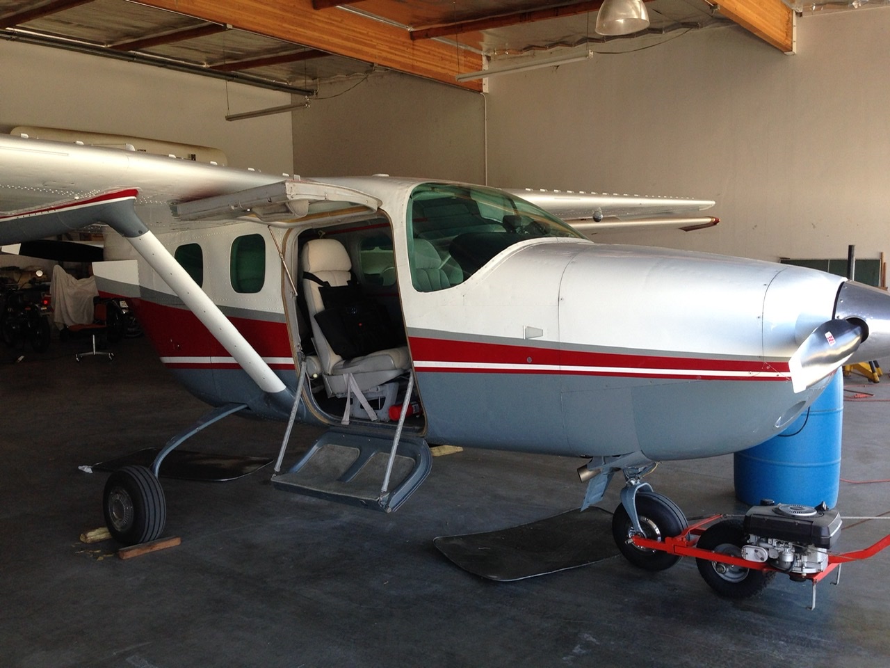

My center post was removed before I purchased the plane in 1995 (1977 337G). I know there is paperwork for the removal, I think a 337 form with some accompanying engineering data. I don’t think it was an STC.
I am not near the logbooks but will be so on Sunday.
I would be glad to either post them to the forum or email them to anyone who is interested.
No sense in going through the extra expense or re-inventing the wheel if it has been done previously and accepted by the FAA
Unread 08-09-22, 04:44 PM
kbecker kbecker is offline
Join Date: Feb 2009
Posts: 118
Please see the attached pictures
File Type: jpeg 17ECB441-9A66-4F09-992E-5673DB51AE94.jpeg (302.0 KB, 2287 views)
File Type: jpeg 7F97E282-06C8-49E8-8372-2E2FC66F015B.jpeg (311.6 KB, 2369 views)
