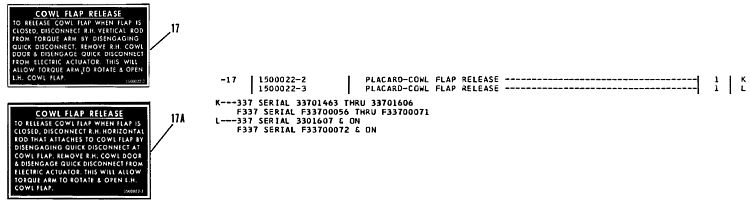

Where are these placards supposed to be?
These are cowl flap placards for the front and rear engines for a G Model. Where on the airframe are they supposed to be placed?
Pictures would be a plus…
Rick

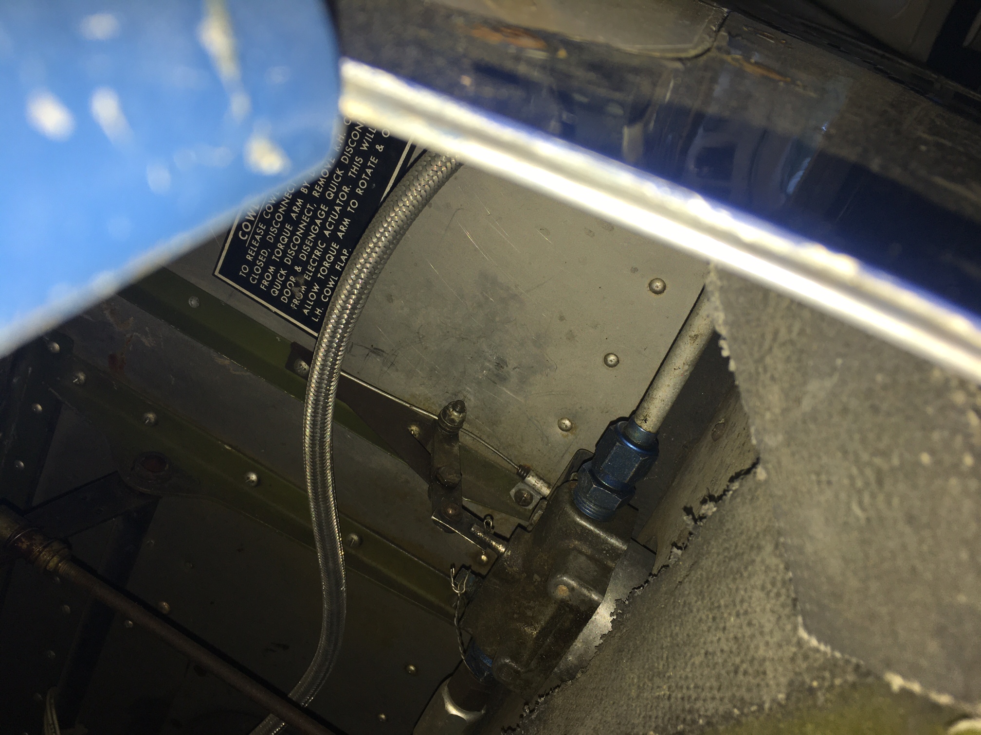

I haven’t been able to get to my plane and I might be imagining this, but I think the rear one is on the firewall visible from the oil door. I theorized so that one can open the cowl flaps with a deactivated motor in a pinch because you really need those cowl flaps open to get the rear cowling off. Manipulation of the quick connector would reaching through the oil door (with skinny hands and arms!). I don’t have a front placard that I remember but expect it would be somewhere near the mechanism but wouldn’t have to be visible from oil door in that case. Just somewhere on firewall that makes sense.
I guess an important point here is that there is a process, especially for the rear, to get cowl flaps open if motor isn’t working for further dissassbly.

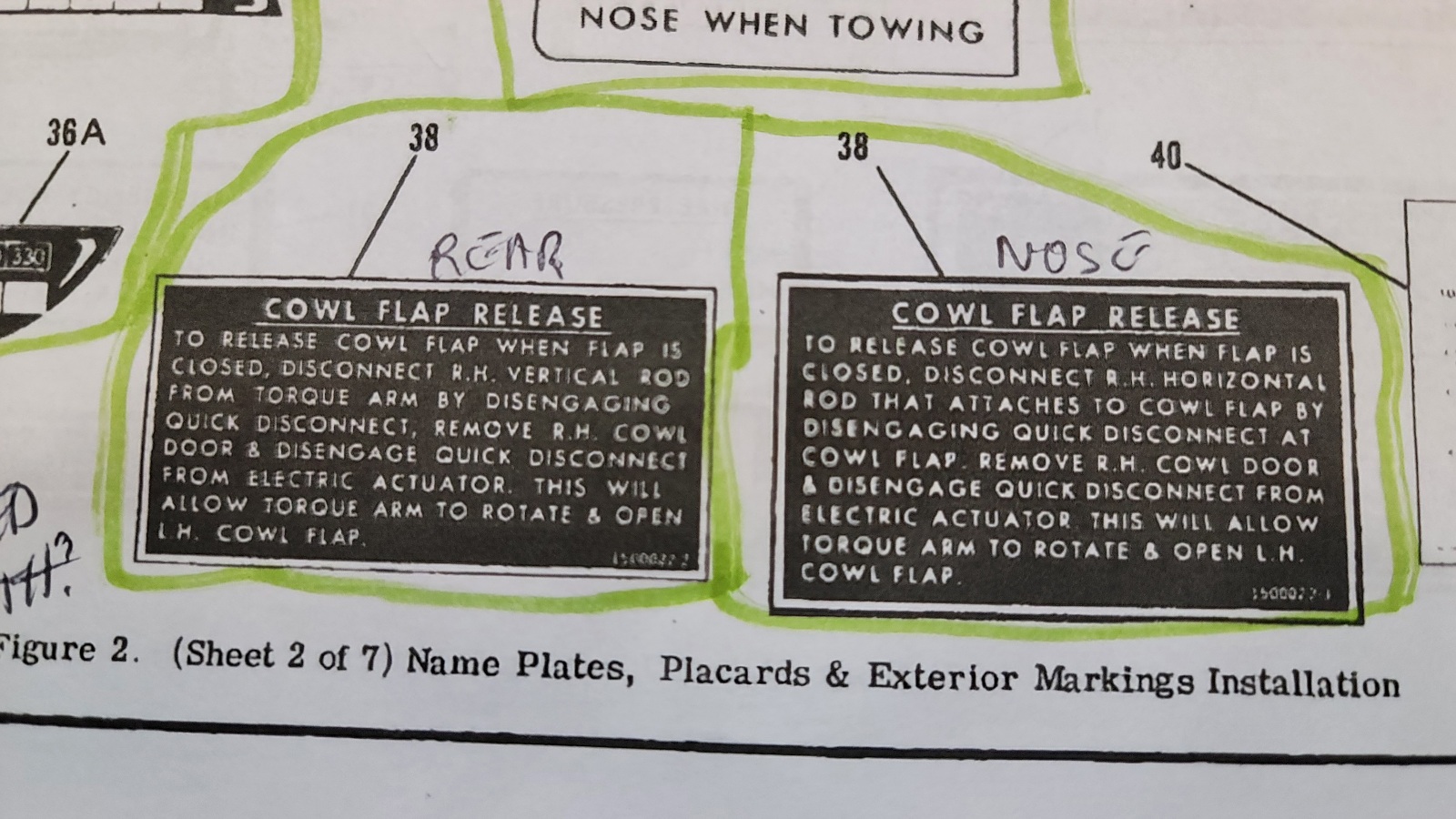

I think I mislabeled the "front/rear" on the image I attached at the beginning of this thread.
In my "P" manual both placards are shown as item number 38. Item number 38 in the textual parts listing is just one item and shows- 1 "Units per Assy", and no- "Usable on Code", so the placards would apply to all planes covered by my parts manual.
I'm thinking there is one placard for the front cowl flaps (as it has the vertical rod), and one for the rear cowl flaps (as it has the horizontal rod) and both placards come as one "unit" under part number 1500022-2 since they are each shown to be item number 38 ... even though there are two actual part numbers as shown on the placard images in the parts manual. Cessna hasn't made this easy to interpret.
Name:  Cowl Flap placard listing.jpg
I expect these placards are long gone from most of our planes. I know I certainly don't have them.

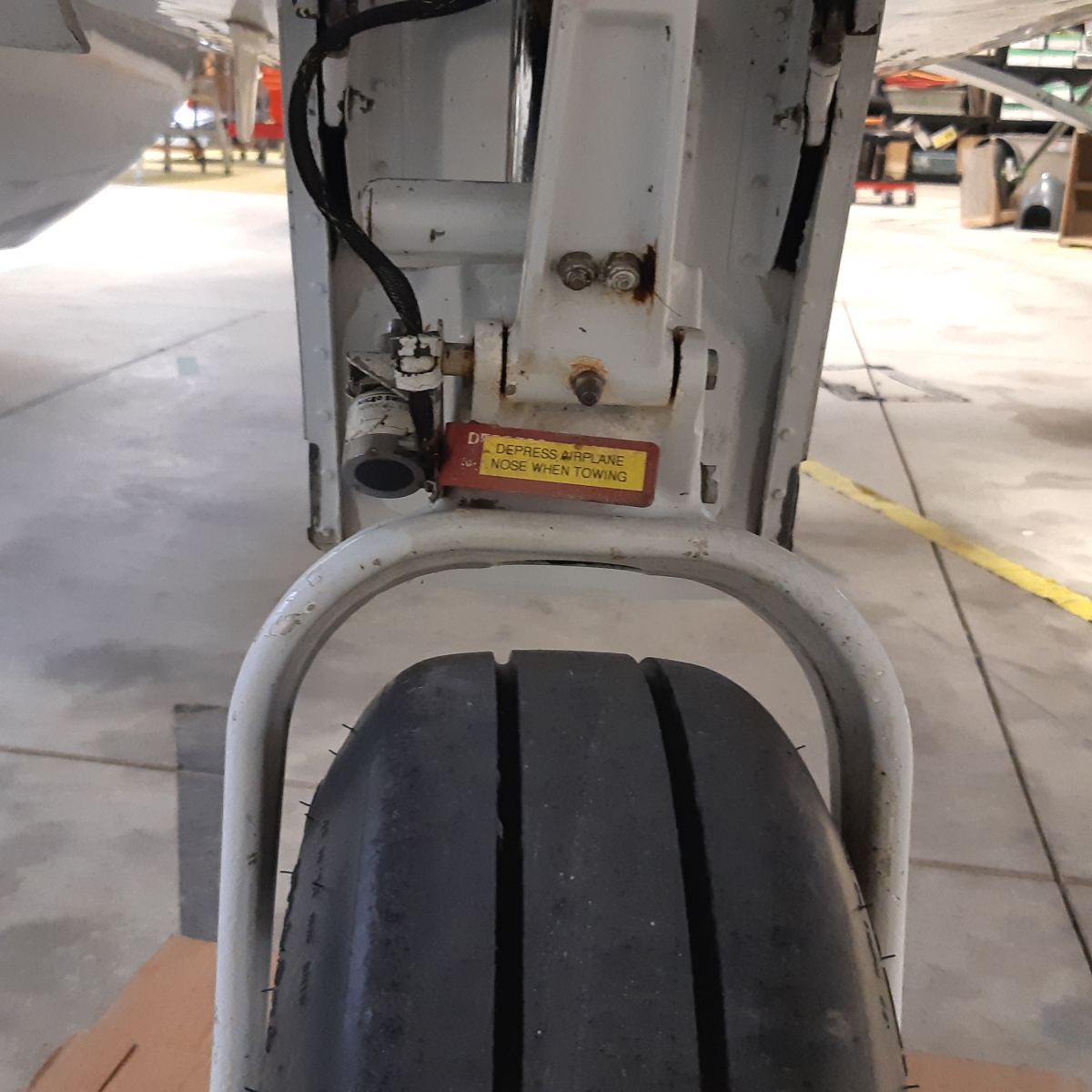

I've never noticed the cowl flap placards. Here's a photo of the nose placard.

Mich3773 thank you for the reply. I have the placard in your photo. I'm looking for the location of both the front and rear engine cowl flap placards that are in the attached photo at the beginning of this thread. Thank you again for your effort.

Here is picture through my rear oil door
Hope it downloads ok
See attached photo link
Look like front one long gone
File Type: jpeg B8121C82-E94D-452A-8029-1033F19F11C8.jpeg (773.6 KB, 7333 views)

Thank you wslade2! That's exactly what I needed for the rear cowl flaps.
Now to fill in the blank for the front cowl flaps...
Perhaps by the oil cooler, like Kim mentioned.
