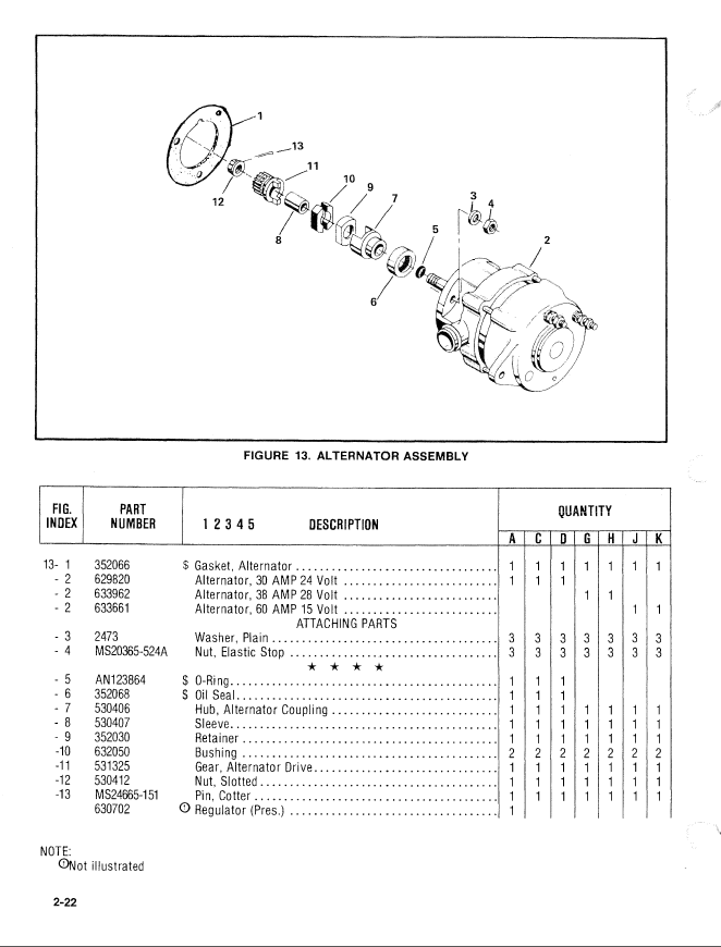

FYI
Ordered a alternator seal using the part # from the Continental IO360 Parts Manual thru Aircraft Spruce Part # 352068
This has happened twice now
Received a SKF 9613
Alternator had a SKF 8648 in it
Just looked at aircraft spruce it it shows this part # is for a Generator Attaching Parts for Continental C85, C90 & 0-200
If you are ordering parts you might want to double check what you need and what you will get

I looked in the Cessna parts catologue - 1965 - thu 1969 337
Mine is 1967 337b
We took all assesories off engines and replaced all seals o-rings and gaskets
Ordered parts from aircraft spruce
Alternatior parts replaced
#1 - part # 352066 gasket - crosses over to 649984
#5 - part # AN123864 o -ring - crosses over to AS3570-111
#6 - part # 352068 -seal - no cross over this was a SKF9613
When we pulled alternator it had a SKF8648 in it
I have attached break down from parts catolouge
1967 337B
