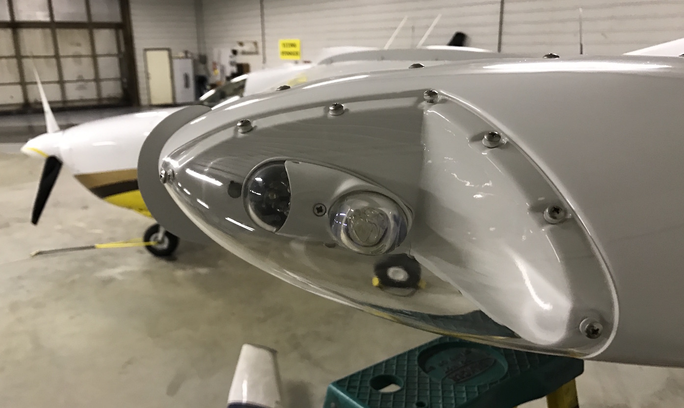

Just replaced one of mine last week with Great Lakes product. It takes a little time to fit them to your tip and then drill the holes. I'd say I spent about 2 hours and I had it mounted. Here's a photo

Just replaced mine as well. There was a minimum amount of trimming required. The lenses fit nicely.
Well worth the expense.
