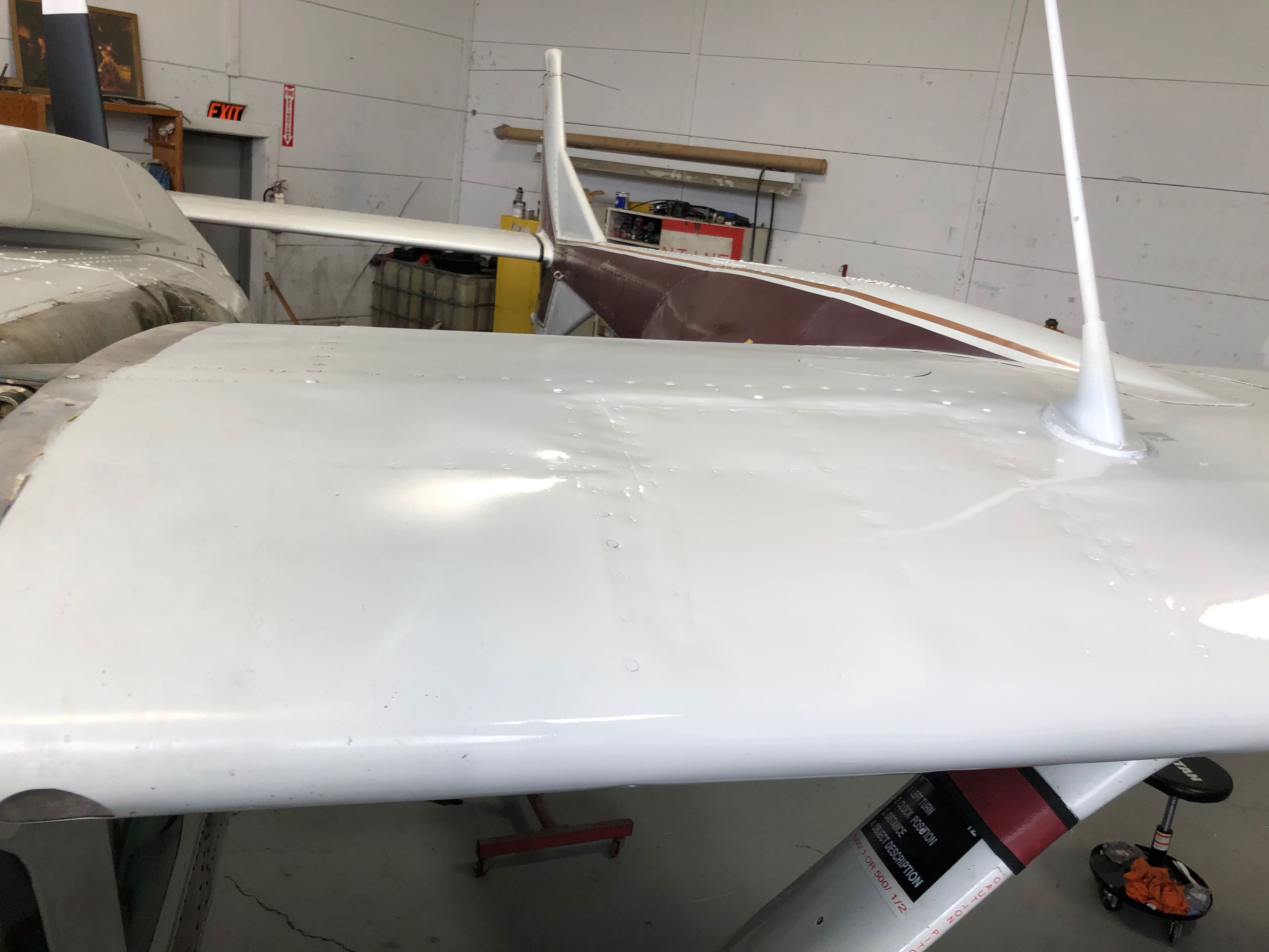

Thanks for all the input. My mechanic was in fact able to repair the damage just as one of you indicated. 3weeks to the day.

Your mechanic did a great job! I don't think the "average" A&P would have been able to make that repair.
