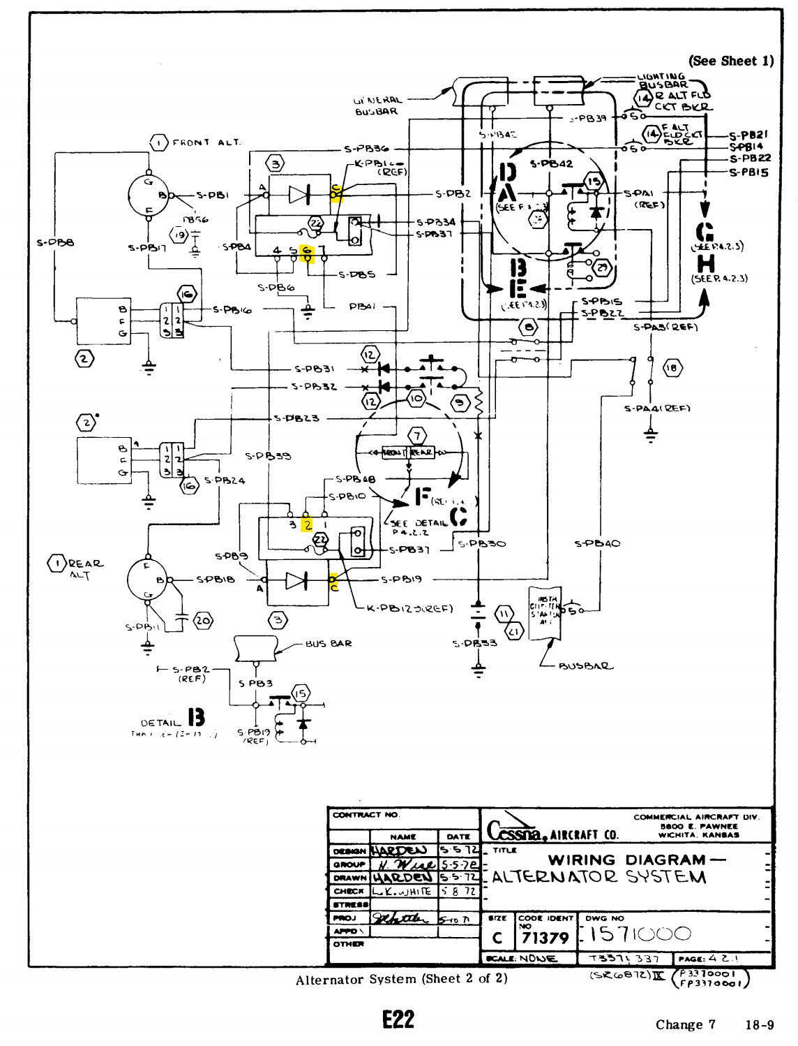

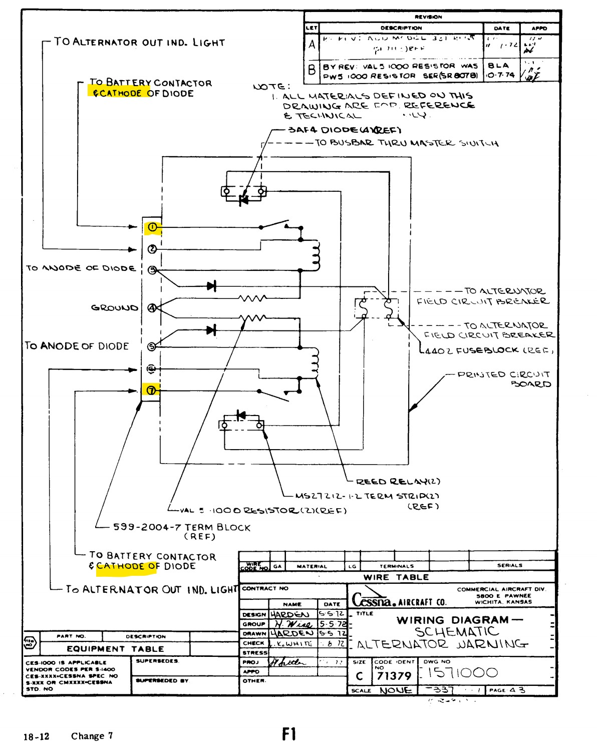

Rear alt field circuit to case= 15 ohms. Book value 10-12 ohms. Good diode test on real alternator.. Haven’t check front yet. Forgot about AC volt test, again.
Ran engines separately and adjusted both VR to 28.0v
Running both engines together showed 27.9-28.1v fairly steady, even with a load of full lights. Annunciators appeared to operate normally....but...rear alt out light would blink occasionally. Looking closely at warning board, we determined terminals 1&2 and 6&7 were wired backwards, with terminal 2&6 to cathodes instead of 1&7. Fixed that, re-ran front engine and it shows 30v. Gave up and came home to some 12 year old Glenfiddich and read old Tom Carr posts in the CPA forum.
I think I need to start over, but none of the troubleshooting guides in the service manual match these symptoms.

Turns out, the wiring diagrams in the Service manual depict the printed circuit board in two places. In one drawing, it shows the circuit one way, and in another, it shows it differently.
When I ignore the drawing on page 4-3, and wired the board as in 4_2_1, magically, the system works. Annunciator lights come on when the switch is off. Adjusted each regulator to 28.0v to give 27.7v (book value with load on). And it all worked. Test flight soon to confirm.
Still have a jittery ammeter, but at this point, I'm willing to live with it until annual when we bring this airplane into the 21st century and install plane power R1224s and an EI Voltmeter/ammeter and pile all the ancient diodes and resistors and capacitors in the middle of the ramp and set fire to them.
