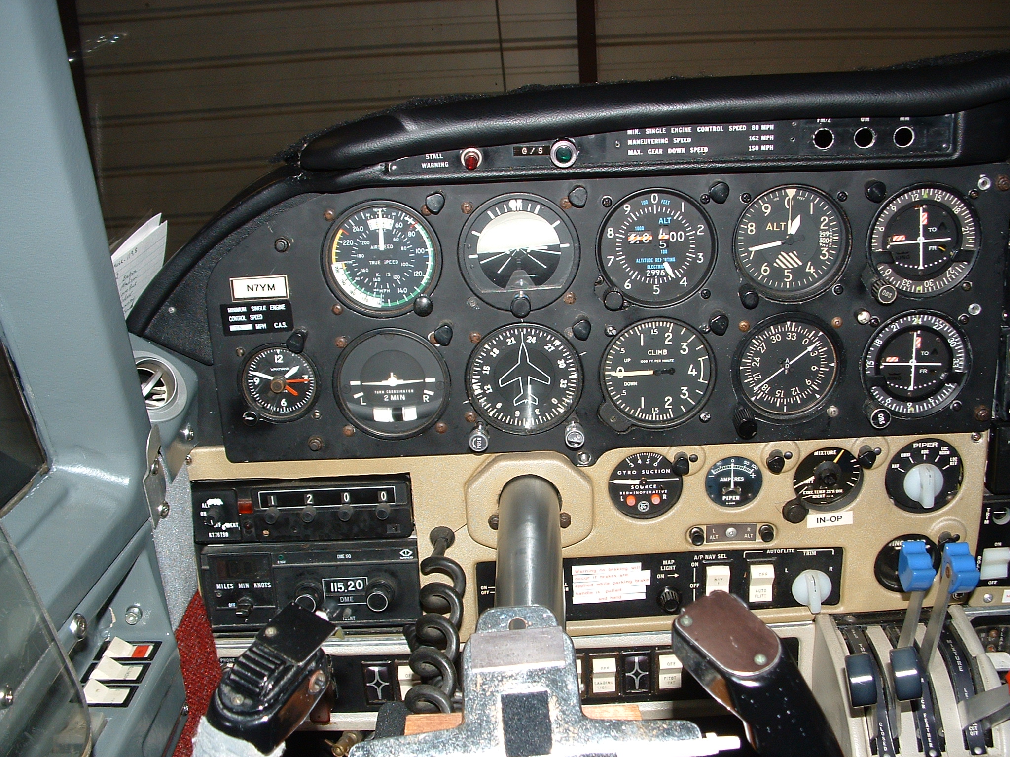

I have an electric Altimeter in the TwinCo. It was in it when we bought it and seems very accurate. Not sure if it has the encoder or the static unit next to it. The static unit has to be there for legality reasons as Jeff indicated. Seems like I have seen these in Trade a Planes from like Airwich in Kansas. Might be a good place to look.

Unread 09-12-08, 08:31 PM
The cool thing about them, as opposed to the ones you more typically see, is that you can dial in 29.97, as opposed to saying, 'should be about there'
