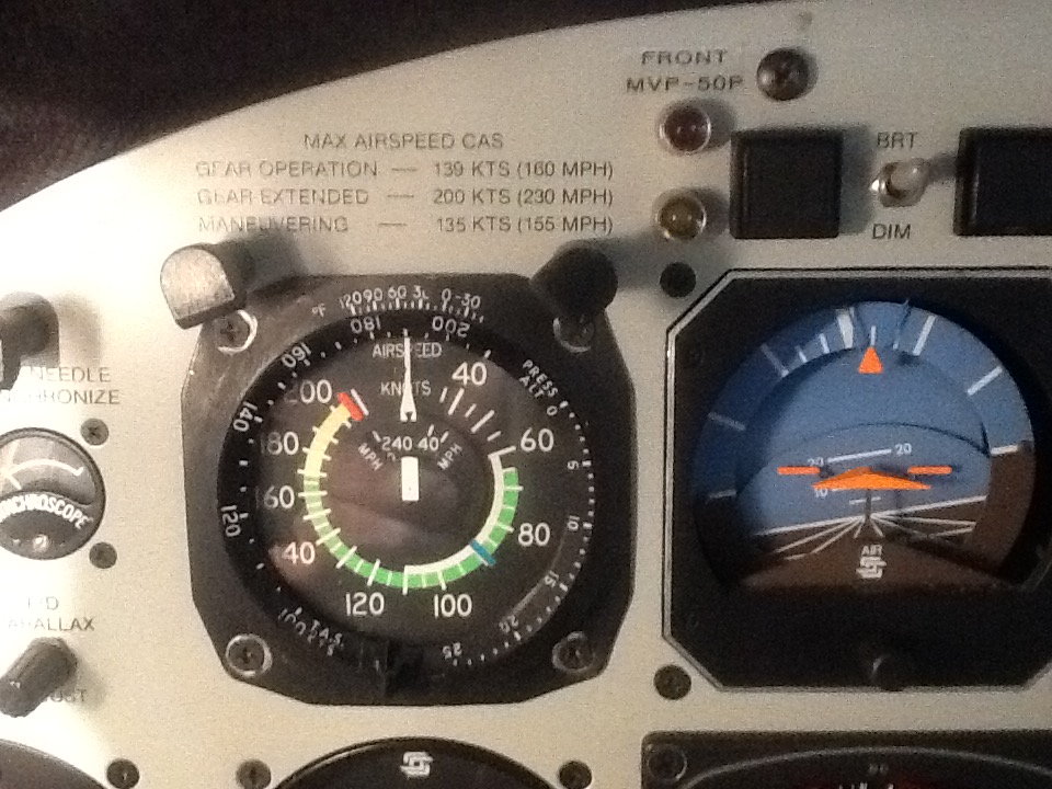

went to the hangar today...

Dual-scale. It's fine.
