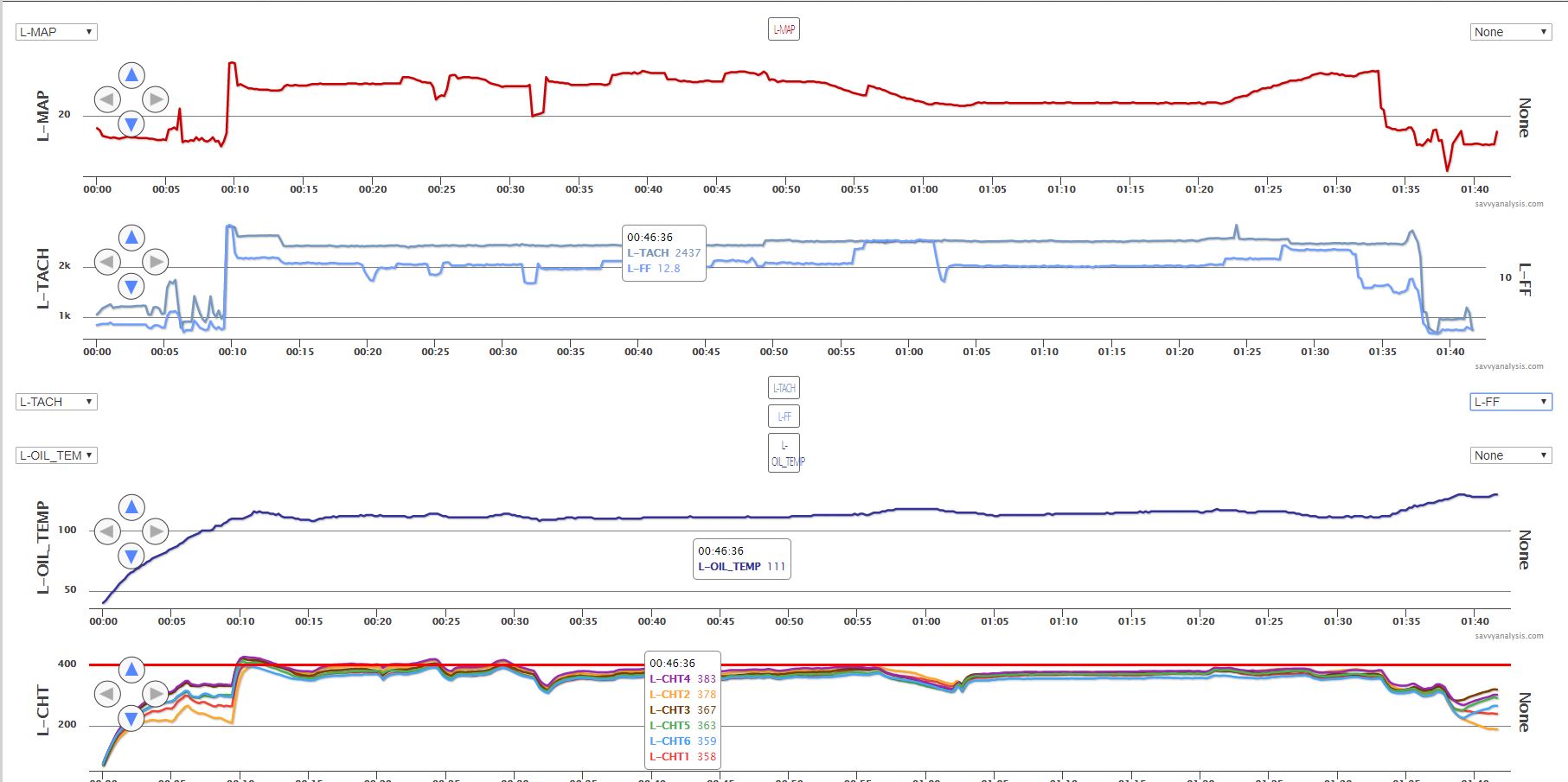

Unread 11-12-18, 04:05 PM
kilr4d's Avatar
kilr4d kilr4d is offline
Join Date: Mar 2016
Location: CNC3
Originally Posted by Mich3773 View Post
Could you post the raw data from the engine monitor, including fuel flow and oil temperature?
Those are in his link from Savvy Analysis, use the drop down menus to view different parameters.

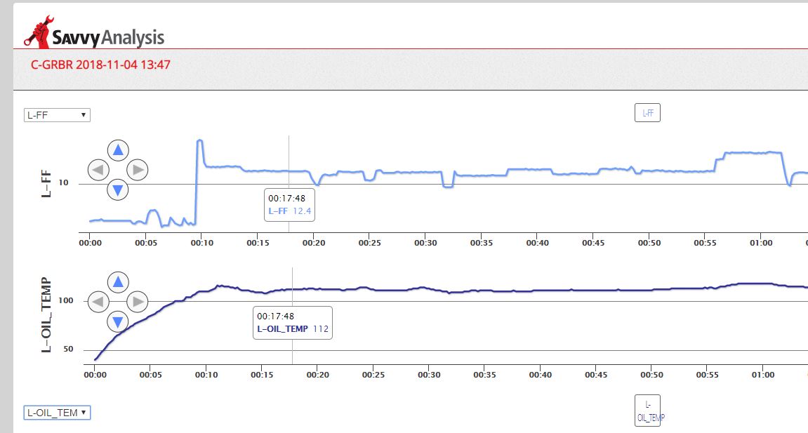

Unread 11-12-18, 04:23 PM
kilr4d's Avatar
Join Date: Mar 2016
Location: CNC3
Digging into this a little more, I think we should note that you're running these engines fairly hard:
Cruising at 25" - 26" manifold pressure, 2450 rpm, 3500' msl, etc. That would put you over 80% power I believe.
Through all this I see that you're running 110 degrees oil temp on the front engine and 128 degrees on the rear engines which is good news. The low oil temps mean that your rings have sealed and the hot combustion gasses aren't getting by them and heating up the oil. Also, I'll bet that fixing the rear baffling helped those rear oil temps get close to the front on your last flight.
How's your oil consumption?
