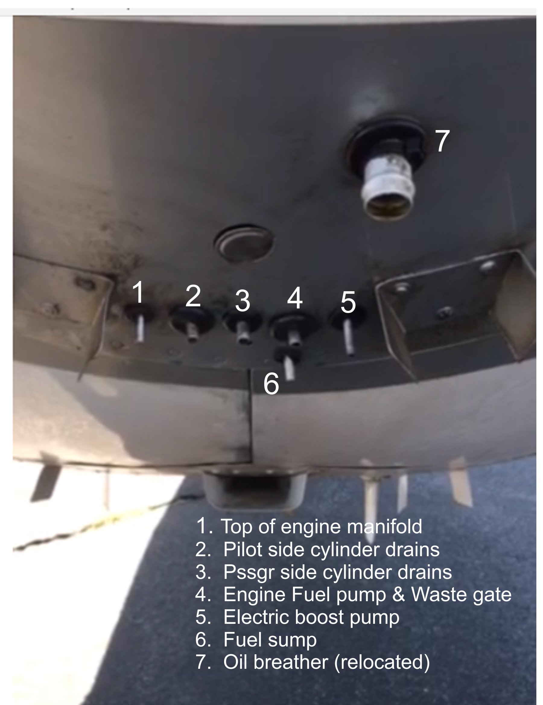

1. Can anyone identify the various drain lines as below?
When topped off I have a steady drip from #2, at least.
If I can find some time will follow the lines up to wherever they go, but I thought others may also find this info useful.
From research, the fuel divider apparently has a 4 psi cut off that may not be cutting off, thus draining into and then from cylinders out the drains?
2. An A&P years ago routed my oil breather (fire sleeved etc) down and out as number 7 in the photo, to reduce breather drool onto rear elevator. After a long descent / flight I sometimes find drool on the cowl, apparently slimed up the passenger side by airflow.
When filled to only 6 quarts everything stays nice and dry. I filled to 8 for this weekend of 7 hours flying and noticed the drool. It is still at 8 qts, so maybe the answer is to leave it at 6 and only bring up to 6-7 when down to 5 qts?
a. Would I be better off with the breather NOT in the airstream,
as it may possibly be sucking out air/oil in its present position?
b. Any other recommendations?

So far
1=
2 = pilot side cylinder drain
3 = pssgr side cylinder drain
4 = eng fuel pump drain
5 = elec fuel pump drain
6 =
7 = oil breather - relocated

on mine, 1970 E model
#1 and #2 are the intake drains
so, yes most likely fuel probably from flow divider not cutting off. As the fuel pressure drops during shut down a spring loaded diaphragm is supposed to positively cut off the fuel.
do you "diesel" on shut down (fuel continuing to run into a hot cylinder, lack of positive shut off)?
does it drip with fuel overhead valves in the off position?
have you felt/smelled the drip (positively identified as fuel)?
Crankcase vent will blow oil out definition....(many variables on how much)
oil is lifeblood of engine. fly with what is recommended, not less. My manual says minimum of 7 quarts. As far as more than 7, I would rather wipe some off than run out.
If the "drool" has increased, be aware of causes increased crankcase pressure.

Could be fuel divider but also check your fuel strainer, identified by pulling the strainer and noting the drain it flows from. Those fuel strainer require some maintenance periodically
My engines settle in at about 7 quarts in the sump and one in the filter. My dipsticks read 6 when I have 7 in the sump. So it's important that you calibrate the dipstick too. Any more than the 7 and it's time to wipe it off
Old 10-06-19, 08:04 PM
Agreed about the fuel strainer. I recently had a pesky drip that required replacement of the plunger.

Updated rear cowl drain map
I think I have them all traced correctly now.
Believe it or not, many transition to firesleeved hoses so it is a bit confusing!
Retracing a bowl of red spaghetti backwards from each end.
When mixture in detent. Cleanly shuts idle.
Is definitely in full idle against the stop.
Doesn't drip immediately on shut down, takes a while before ...drip drip drip.
Drip from LR cylinders definitely stops w fuel closed overhead.
Still drops with newly overhauled flow divider from QAA.COM.
Still drips after a while, and then endlessly.
Flow divider spec only supposed to hold 1 PSI for 2 mins.
Thinking what else could be seeping fuel into cylinders, ...I thought of hand primers...?
Noted from your comments,
I discovered (after 25 years) that hand primers have a lock position.
I have used them so rarely, I never noted the actual detent position before.
Generally I'd just push them in and twist, but apparently not locked.
Fuel back on.
We will see if drip resumes with primer in detent.

There is a check Valve in the engine driven fuel pump return line it could be faulty and allowing fuel back up thru the system. I’ve seen it twice on our planes

Still dripping
Looked up parts diagram and list
-40 check valve pump to manifold.
Will check that out.
Makes sense.
From the drawing
the check valve appears near / under the elec boost pump
In Engine compartment or inside firewall?
Hard to tell.
Will find it tomorrow.
Thanks!

On our T337H’s the check valve is under the headliner above the baggage door.

Found mine
Little red devil in front of rear oil cooler, oriented vertically
arrow down, into airframe (and I assume back to manifold and tanks)
Same?
Pulled, cleaned,
did a light sun n blow test.
Seemed OK
Re-installed.
No change.
That said, it relies on its internal spring to stay UP and closed, and spring is very weak.
So IN airplane might still drool?
So maybe replace anyway?
Later models they mount horizontally. Probably for that reason.
QAA.com says with mixture in idle cutoff,
light pressure in the flow divider and its check valve shouldn't really matter.
cutoff is cutoff.
Other ideas?

crack the line going from fuel pump to "throttle" / flow control with mixture in off position, tank valve open. See if there is dripping. My expectation is there should be no flow (ie-cutting off the engine is achieved through no flow through the pump).
What I understand the purpose of diaphragm in the flow divider is, is to provide an "abrupt" cut off of fuel flow as the pressure drops from cutting fuel pressure via the mixture on the control on the pump. But it is not your "stop" of fuel flow. It just provides a clean break. Your pump should be the control that alters fuel line pressure or stops fuel flow.
Old 10-26-19, 01:51 AM
Having some work done so I went and checked my aircraft, and surprised myself.
I have no drips. With mixture off and tank open, cracking fuel line between pump and flow control/throttle resulted in quite a trickle of fuel flow. Same when cracking line between throttle and flow divider. So good trickle is the norm there. Norm pressure appears to be low enough that flow divider IS the final cork in the system.
This makes me wonder if your fuel drip is from some other source than primary fuel supply as you have new flow divider.
You checked check valve. Try cracking line on engine side of check valve and see if leak there. (I would think if it was problem though you may have seen fuel flow while you were servicing valve before.)
But I would be very suspicious of the primer. Primer injects fuel directly into the manifold at the "U-bends" near prop end of engine. You will see two small stainless steel lines that tie into the "U-bends" one for left and other for right bank of cylinders. Try loosening the flare nut and disconnecting those and see if there is a drip from there with tank open.

Also, sometimes the o-rings in the throttle control can shrink/set/deteriorate and there can be leakage around the shaft into intake. You would have to loosen the clamps to pull back the flexible intake tubing at the "Y" of the intake to detect that.

Interesting...
I bought an OVERHAULED flow divider from QAA.COM ($450 as I recall).
So assume it was done correctly. But you never know.
I still have the flow divider came out. I think it is newer, circa 2008 when engine was OH.
Maybe I should have it checked for pressure?
If the pressure on the old one okay, then the old/new OH divider not likely the problem.
Yes, check primer line next.
And hadn't thought of the throttle leakage possibility.
Probably good to check before pulling and send fuel pump (and $800+) to be 'overhauled.'
Any place one can suggest to more reasonably just get them 'pressure checked?'
