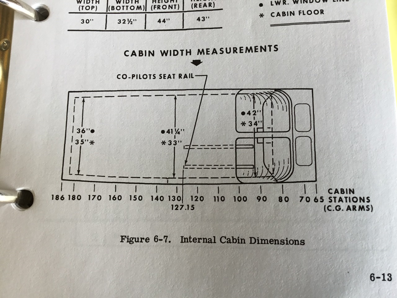

Hi Braden,
I have a new T337G manual and this is the only thing I can think of that gives the station points for the airplane.
Is this what you are looking for? If not, can you use the stations from your equipment list for your intended purpose?
Rick

Thanks Rick, those will help. I received a couple of direct emails as well, so I should have what I need. Appreciate the help everyone!
