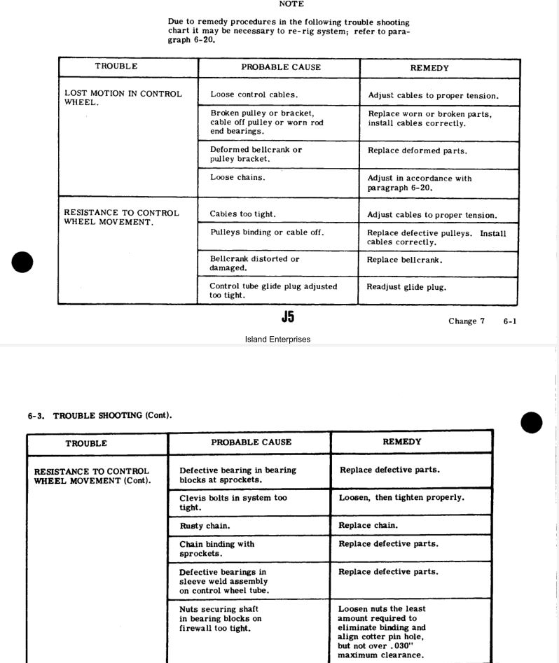

Here is the "ailerons stuck" troubleshooting guide from the manual
